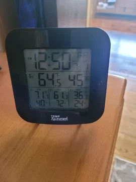

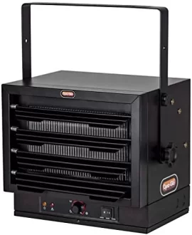

I heat entirely with wood and my plumbing is in the crawl Space. I built a wall across and only heat where plumbing and well pressure tank is.im good to not put heat on under there till around -10c.i run a 3000 watt electric heater hanging from floor joists.i have a 3 sensor thermometer I bought from Amazon. I put one on each end of crawlspace and I have one in my fridge.it can get real cold here and I've never had pipes freeze.

I also have a weather station and keep two sensors downstairs in the basement to keep an eye on the temps, one on the floor and one up a little higher against the wall. Generally when we are burning wood we have our basement drop to the low 50s and when I get home I see it back in the upper 50s.
Temps drop in our basement pretty quick. Once it gets to about 52 it takes a long time to drop to 50. The coldest our basement has gotten was 49.6. Makes me a little nervous. I do plan on insulating our joists this winter until we fully finish it. I think it would be a good idea to cycle your furnace until you get familiar with how cold your basement gets.
