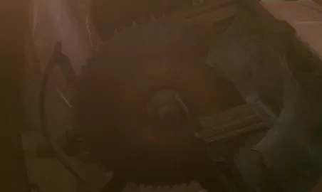

ok dex I will try the blade is about 3 1/2 ft round def not a table saw blade the belts are the biggest ive ever seen had a feeling someone would take interest in it, funny thing is they left it, unfournetly they sold the 1927 ford truck that had are you ready for this a 1927 dated crate motor not sure why but it was there

Thanks for sharing the pics of the saw mill. that is amazing, I love seeing old mills like that, definitely a part of history you have there!

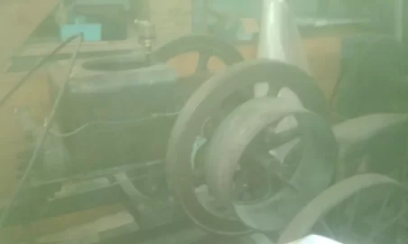

That sure looks like an old hit and miss engine that runs off of fossil fuel from what I can see in the pic.
I will not argue that fact with you , all I know is it came with the house and the 67 old granson told me it was a steam powered engine to many things on my plate never got a chance to really look at it to be completely honest
