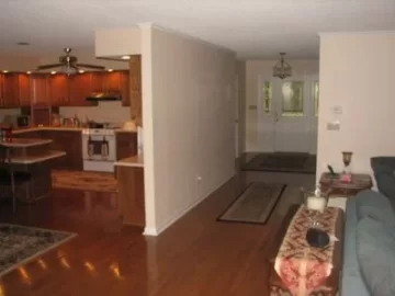

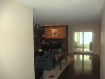

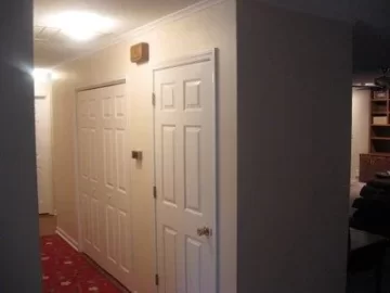

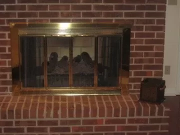

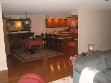

We have a 2,936 sq foot ranch home that want to heat with an insert, the areas that I'm concerned about this the living room (where the fireplace is) that opens up into the kitchen and dining room, and four back bedrooms. I think that my layout is open, but the local BK dealer thinks that the princess is not properly sized for the job. The dealer also sells the Hampton 300 that he's pushing me towards. For me, looks isn't the most important criteria, but my wife and I are looking for something that will heat the required space and go with the decor. The currenct setup is an existing, interior masonry fireplace, width is 41' in front and 34.5 in the back, height is 27.5', depth is 22.5, mantel extends out 16 3/4' and is 12' high. I have good insulation and windows and my ceilings are nine feet high. We are looking at the BK, Hampton 300, Jotul and Clysdale; I favor the BK because of its ability to set and forget and overall control of the stove seems easier from my research. Again, this is a decision that two of us are trying to become one on, all of the above are still on the table.
How much difficulty will either of the stoves have trying to put the heat in the required areas? My pics are below:
1 - Current fireplace
2 - Living room open to kitchen/dining room
3 - Expanded view to front door and hallway to the right
4 - Front door to fireplace
5 - Hallway leading to bedrooms (cold air return located in the ceiling of this run)

What's the total sq footage you want to heat? By the looks of those pictures, it appears to be significantly less than 2,900 sq ft. If so, the BKP will have no problem heating an area of <2000 sq ft. You might have an issue getting heat to the back rooms (fans will help), but that's a problem you will have regardless of the stove/insert. Remember, these are space heaters. I'd expect the BRs to be at least 5 to 15° cooler without active air management or suplimental heat, but again I can't see the floor plan to make a better guess.

The total square footage of the home is 2936, not the area in the pictures. The area in the pictures is what I want to heat. The fireplace is in the living room and it opens to the kitchen and dining room (pic #2); these are the areas that we spend the most time in. Picture #2 is right in front of the fireplace looking into the kitchen and dining room. The hallway leading to the bedrooms is <20 feet from the where the insert will be located, these are the rooms that I want to heat. If you look at pic #3, this is taken standing right by the fireplace and shows my front door. The hallway to the right before the front door leads to the bedrooms.
The Princes will do the job. No question about it. If you need more convincing call BK - 1 509 522 2730 Ask for the tech department.

I think just about any 2.5+ cubic foot insert would heat that space (and more). It's nice and open.
Love that raised hearth- wish mine was like that.

Initially, I wasn't a fan of the raised hearth, but I'm liking it now. I like the idea of having an insert sitting on it and radiating heat into the living area.
