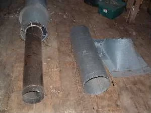

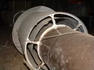

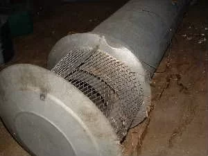

I am planning on getting an Englander 30-NC in the spring and have this chimney leftover from the previous owners. Will it work? (the inside is 8") It is a triple-wall pipe.
I'm new to posting photos on this site, I'm not sure if I've done it right.
  • [Hearth.com] Will this chimney work?
Pipe itself looks OK, but you have to recall that you need to take a look at the code for your area and make sure your height and distance from the closest place on the roof is within limits. And, you have to make sure you have the right components to go through any other areas within the structure. I suspect you'll need more parts than you show in the pictures.
