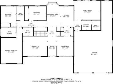

We are currently in contract for this home. There is a fireplace in the family room which is in the top right corner. This is a ranch house with a large attic over the entire structure and there is also a full basement.
We’d like to get an insert for that room and I’m sure that room will be real toasty. How do you think it would perform for the rest of the house? Do you think we’d have to get a unit for the master bedroom in the bottom left of the picture?

I like your house design. I like one main floor, and a basement too. My garage is detached with a workshop add-on. You seem to have left yourself a nice spot in the garage. Inserts are meant to go into masonry fireplaces as more of a retrofit. You would be looking at a wood stove/fireplace I believe on a new build. Your house is closed up with walls, so the heat will not leave the room easily. You could also bake yourself out with too much heat. What will be you main heating and cooling system (s) ?
I would think it wouldn't be so good for the rest of the house. Because the family room is off from the main part of the house. Possible to have 2 stoves? - maybe the insert and a free stander? or one stove centrally located? The living room (by the staircase) looks to be in the center. Any chance for a free-stander in that location? I guess it depends on how much you want to heat your house with wood - all or partial.
Their is a closet(?) on the other side of the staircase - maybe that could be turned into a nook for a stove. That is even a more central spot.
Wood burning fires are not allowed in bedrooms.

The floorplan is not great for convecting wood stove or insert heat. An insert in the family room will mostly just heat that room. The family room is a separate wing. A stove in the living room would work better.
Good idea. Looks like no doors, and lots of wide halls. Much better for wood there. The window commands the best spot, but could go out the roof if placed on the wall or other corner.
This x2! I had a similarly laid out home with a gas stove on the living room. That would hear most of the house through early winter, the extremes of the home seemed to be about 10degrees less than the living room, which was pretty nice.

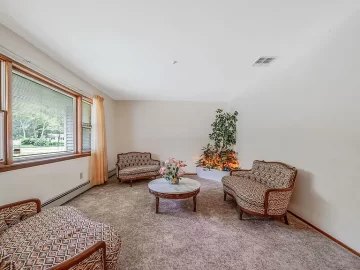

Thanks everyone. Here’s the latest. We had the fireplace store come today to visit the house. He agreed that the family room really wasn’t ideal for us and I brought up the idea of a free stander in the living room. My wife and I discussed placement with him and we ultimately decided on placing it in the living room where that tall fake plant thing is. The pic isn’t our furniture, it’s from the listing.
We went directly to the store after he left so we could look at the models. I liked the larger defiant and they were willing to sell it to me but they really thought the Vermont Castings encore was the best fit for us so that’s what we went with. Went with the cast iron look too.
Installation is set for a week and a half from now, fingers crossed. :-)
