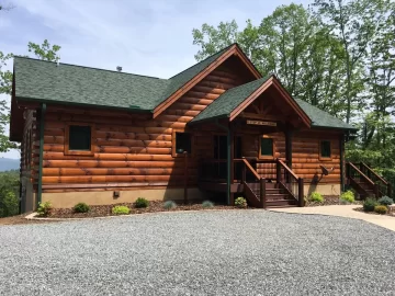

I have a Jotul F500 V2. An hour into my burn a big wind gust put out my fire. This happened twice. I had to open the stove door a crack to get it back. After that it was smooth sailing because the wind either shifted direction or gusts weren't as strong. Is this what a back draft is? We have had issues with wind before and still haven't decided what the best course of action is. We don't now whether to add length to the chimney or get a wind cap. Worried with a wind cap that cleaning will be an issue. We clean from the bottom up. We are not getting on the roof. We are not full time burners and do not do overnight burns that often.
Is your chimney protruding above your ridge line?

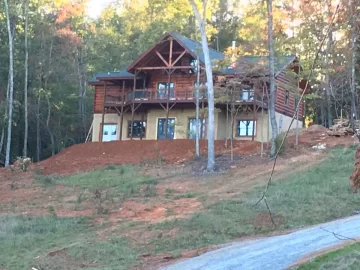

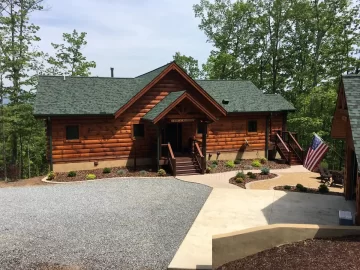

Here are pictures. The first is from the front of the house taken from higher ground. Second is the back of the house taken looking up from downhill. Third is ground level. From some vantage points it looks like it is higher and others I can not tell.

Hm , ridge line seems fine..it could be the geometry of trees and hill slope.

I’ll take a stab it being we have a log home too. The house no matter how tightly chinked has a lot of air infiltration. Depending on wind direction it can induce a Postive pressure in the room or a negative pressure.
I’d check historical wind direction on the day it happened and relate it to what side of the house it hit on.
Second walk outside and or get on the roof and look for possible trees or buildings that could shift the angle of the wind towards your stack.
We had some wind inducted back puffing which took a long time to figure out. I intentionally made the stove smoke badly and got up on the roof and studied the smoke pattern and discovered the steep roof pitch was inducing a wild eddy current when the wind blasted out of the south west. Even though we have a tall stack and strong draft simply adding 3 feet solved the issue.

Extending the chimney on that setup looks like it would need a lot of support. Might be better to just be under roofline but still within code.
What direction was the wind relative to the house when it you had a puff back?. My guess is that is what you saw. The wind didnt blow out the fire as much as the change in draft created a sudden increase in air that ignited unburnt fuel. My guess is the wind was coming from the front of the house and out the back downhill. Wind likes smooth surfaces and normally the flow is in parallel layers stacked up from the ground up in the air. Its called laminar flow. Once the velocity increases the air starts to "stick" to the ground and then "unsticks". this will create circular swirls of air near the surface creating turbulent flow. So even though the overall wind is going in one direction, the wind near a stationary surface can be swirling in multiple directions. This effect can be accelerated with sloped roofs and open areas in the surrounding canopy. It looks like the surrounding tree canopy is higher than the house, this creates a area of turbulence around the house. There is no substitute for elevation, the air gets smoother the higher up you go but in some cases, it is not practical. I used to work in a factory in a valley. In order to keep the stack exhaust out of the valley we had to have a 310' stack. Even with that is the conditions were right we could see 100 foot swirls of vapor coming off the stack if the wind were right. The only way to really diagnose the issue is wind tunnel testing but I do not expect many folks would be interested or could afford it.
