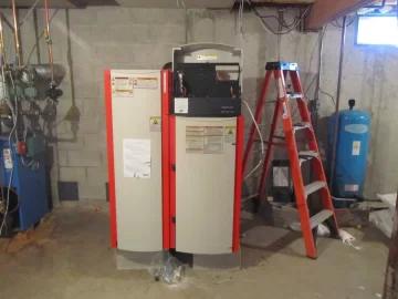

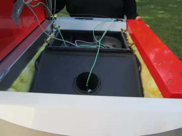

Hi Guys:
This morning I had a Windhager Biowin 260 pellet boiler delivered and the install began. The install will finish tomorrow and the boiler will be commissioned. Prior to purchasing the boiler I had done a great amount of research into most of the different brands of pellet boilers available in my area, New Hampshire. The Windhager seemed like the best value for the money by far. Prior to purchasing the unit I met with Marc Caluwe at his shop. He showed me the boiler and fired it up. It is a quality piece of equipment and the Windhager name is well known and respected in Europe. I look forward to sharing with all of you my experience with the boiler and answering any questions.
[Hearth.com] Windhager Biowin 260 Install w/ Pictures
Wow! Looks like trying to fit 10 pounds in a 5 pound sack going down into the basement!! That was nice work whoever did it.
You will like that boiler. Very few heating products of any type have impressed me as much as that particular piece of equipment. It is as close to "fire and forget" as you can achieve with solid fuel.
The plumber had a friend with a tow truck with a boom and he only charged me $55 dollars to drop it in even though it took over an hour. It was a very decent price as far as I'm concerned. He scraped it a little going in but it's just cosemetic. It was definitely a tight squeeze.
Marc is coming out today to comission the boiler. When I woke up at 5:30 this morning it was still 65 degrees in my house even though we've not turned the heat on yet so I think it might be another week or two before the boiler starts getting used. It could be tomorrow though. Last week we had a day in the 90's and this week the temps been getting into the 40's during the night. That's New England weather for you.
I'll be posting some more pictures tonight of the finished install. NH has a 30%/$6000 rebate for pellet boiler sytems but one of the requirements to qualify is a 3 ton or larger hopper. I've been thinking about doing this but don't know if the numbers will make it cost effective. I was considering building my own hopper as a few others on here have done. 3 tons would almost be a years worth of pellets for my home. It's pretty appealing to think that I could just fill the hopper once August or September and then not have to lug another bag of pellets into the basement for nine months. I looked into the pellet delivery trucks in my area but I think it would actually be more per ton than if I picked up a ton here and there myself at the local retailers.

Here are some more pics of the finished install:
