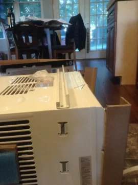

So I bought a Danby 8k btu window a/c unit today to install in my wife and i's bedroom since our house has no central air. I get it home tonight and open it up, start reading the instructions and figuring out how to install it. There is a top "L" bracket that installs on the top of the unit and the window is suppose to slide down into so that it holds the unit. Well our new Anderson double hung windows are about twice as thick as what this "L" bracket is designed for. Is this a common thing with new windows? We're these windows never designed for an a/c unit? Any help would be greatly appreciated.

That is the model. There is a bracket that screws to the top of the unit that the window slides down into. It's one of the first steps.
Not following. The L bracket should just provide a stop. I would think the window thickness to be almost irrelevant especially if the L bracket position is slightly adjustable.
Yeah. I have thick old double hung windows and the top bracket on my window A/C units are "L's" that just hold the top. Are you saying it is a channel shape?

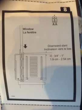

From the manual ....PLEASE NOTE: Window applications come in a variety of different styles. Therefore, it may be necessary to modify your particular installation.

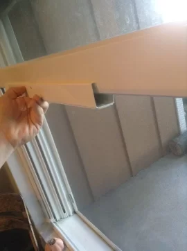

Looks like you have the L shaped piece in the right position on the top... Illustration looks like it should have sash drop into channel but that isn't going to happen with your window. Likely works with vinyl windows not wood....
I really hate the so called mounting kits that come with AC units. I ended up cutting a sheet of plywood the full width of the window and cutting a hole in it to fit the AC unit. I then put in a few screw holes in the window casing and was done with it.
I would just cut that lip off with a grinder and make it look like a real 'L' so the window could rest in it.
I think.
Might also put a piece of sticky-tape foam insulation strip on the inside(s) of the L for things to rest against - so the unit isn't pushing into the window right on that L-edge. Or maybe even cut that little lip off too. And do the insulation strip.

That is an U channel. That is somewhat goofy as an option given the variance in window thicknesses. I agree with the others, either cut off the short leg of the U or get a piece of 1.5" angle aluminum and make your own L bracket.

If this is too 'ghetto' for you, take the bracket to a metal fab shop with a brake and have them bend you a piece of aluminum that would fit.
I love me a good custom install.
Or just use a piece of right angle aluminum. Spray paint it glossy white. Boom....custom job that looks great.
Leave channel alone. That short leg of the "U" is to hold the frame for the side louvers. Window just comes down on top of short leg, behind taller leg, as you show it positioned in your first photo. No modification required (or desired).
