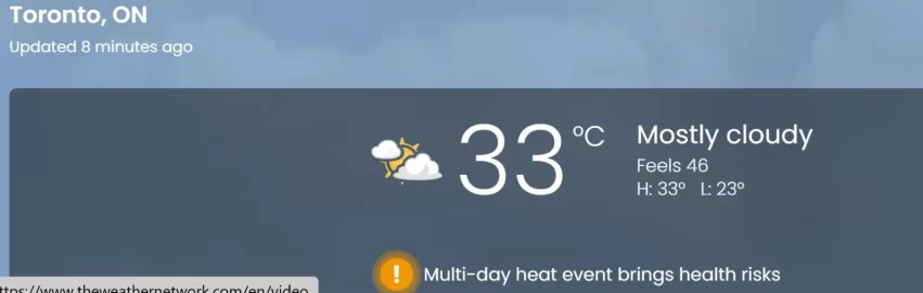

Are you getting ready for the heat wave? I guess Southern Ontario is going to be 30C and feel like 40 soon. We are into some warm humid weather here now. Good for the tourists I guess.

The heat and humidity started the day before Yesterday.
