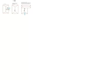

I'm hoping someone can enlighten me on what's going on with two different situations where I experience downdrafts with wood stoves.

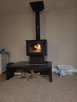

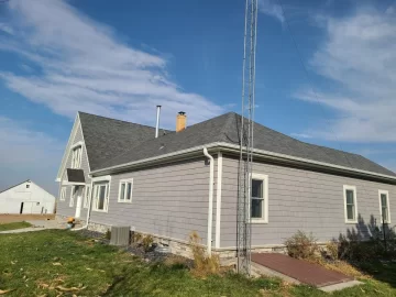

The picture on the left is my parents' house. They have a wood stove on their main floor and a class A pipe that is on the East side of their gable roof. The top of the pipe is below the roof ridge, I'd guess by 2 or 3 feet. It has been this way for about 40 years. They have always had downdraft issues when there is an East wind (blowing East to West).

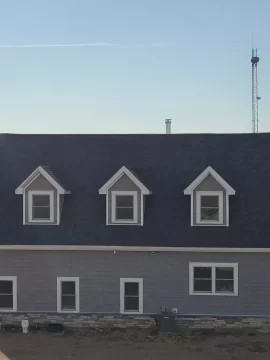

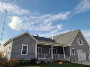

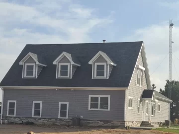

The house I live in had a hip roof with an unlined masonry chimney. There was a wood stove in the basement and one on the main floor, both using the unlined chimney. We never had any downdraft issues and the draw was fine, maybe too strong on windy days. We recently added on a gable roofed addition to the north and since then have consistently had downdraft problems with a South wind. No way to have a fire in either stove with a strong south wind. Also can smell the chimney in the summer with a strong South wind.
To get up to code we had an insulated liner installed in the chimeny for the basement stove and moved the main floor stove across the room and had a class A pipe run up through the roof. The basement stove got done first. I noticed a downdraft in it after the liner installation but wasn't too worried since we don't burn the basement stove that frequently. Decided to not have a fire in the basement if there was going to be a South wind. The main floor stove and pipe recently got installed and we tried to have a fire with a South wind and filled the house with smoke. The stove had been burned the previous couple of days and was still warm this morning but when I added wood I couldn't overcome the downdraft.
I've expressed my uneducated opinion to the installer that it seems like the downdraft is being caused by the wind hitting the roof peak, swirling in a circle, and going down the chimney/pipe. This seems to be the situation at both my house with a South wind and my parents' with an East wind.
I've talked with the installer and he believes there is something else going on. That there must be something with the house causing a negative pressure. We turned off our furnace and checked bathroom exhaust fans. Also tried opening a door and burning the fire. Same situation: downdraft.
The new class A pipe at my place is close to the same height as the addition ridge. I plan to have this extended and bet the issue with that stove will go away but I'm curious if others have had experiences like this?

Thanks. We never had downdrafts before the the addition with the higher-than-chimney peak and we only have downdrafts with a South wind. The stronger the wind the stronger the downdraft. When we were doing the addition I had asked the contractor if he thought we'd have problems and he said no because the chimney is so far from the addition's peak (maybe 20-25 feet). And the installer of the new class A pipe for the main-floor stove said it should be ok that the top of the pipe isn't over the peak because it's about 10' away from the addition's peak. I think extending the class A pipe above the positive pressure zone created by the addition's peak will solve that issue. Not sure if I want to address the same issue with the masonry chimney liner though since that would require adding to the masonry chimney and we rarely use the basement stove.
I talked to the installer and he came and we installed another 3' section of class A pipe. We are definitely above the highest peak of the house now and the downdraft issue decreased drastically but not completely. Once the fire got going it hasn't back smoked any more but what will happen when the fire goes out? We're supposed to have 3 days and nights of strong South winds. If the fire goes out in the night with the wind blowing are we going to be choking on smoke and other potentially dangerous gasses?
We have 18' of class A on the roof and about another 4' of single wall below that. The installer is baffled. He thinks we have some other negative pressure issue. I wonder if we're still not quite high enough above the peak? The one issue I could maybe see with negative pressure is that we have more windows on the North side of our house than on the South side. Maybe we are getting negative inside pressure with a South wind because of the extra windows?
Edited to say: Sorry, there's not 18' of class A on the roof. There was 6' on the roof, now there's 9'. There's an additional 12' of class A in the attic and 4' of single wall below that. Honestly, that seems like too much in the attic. I don't think our attic is that tall but the installer said they did 18' of class A originally so I'm just going with that :)

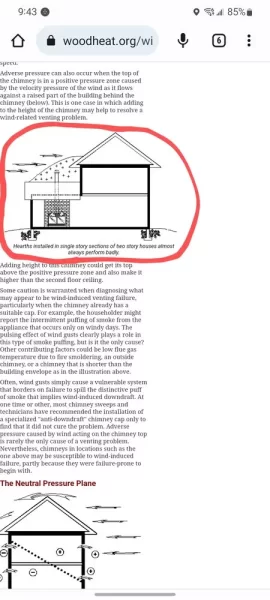

From the woodheat.org site:
A chimney with no cap is the most vulnerable to the adverse effects of wind. A cap, particularly one that has baffles to prevent direct line of sight access to the opening (as opposed to a simple flat rain cap) provides significant protection from the adverse effects of wind. In fact, research has shown that caps with baffles (of the sort common on factory-built chimneys) can actually enhance draft regardless of wind direction.
[Hearth.com] windy day downdrafts
This kind of cap can take adverse winds and convert them to upward flow in the chimney.The cap shown at right is the type of design common on factory-built
chimneys. Note that the baffle, in the form of a band between the cap and the skirt at the base of the cap, prevents direct access of the wind to the open top of the chimney. This simple design consistently produces a driving pressure at the top of the chimney, regardless of wind direction or speed.
That might work, it's worth a try. Ask your stove installer if they have one that they could lend to you as a test. They should also be familiar with wind related draft issues and cap solutions. Another one is the rooster tail style.
I showed the installer this picture and the woodheat.org link and he didn't think it was applicable at all to my situation._g
I asked previously about wind caps and I don't think he had any recommendations or familiarity, unfortunately.

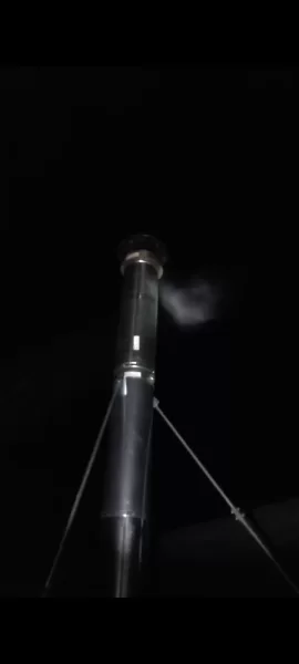

Last night I started a fire and got up on the roof with a flashlight to try to see what the smoke was doing. With our the strong south wind the smoke was blowing out almost straight sideways to the North. At times I thought it did go down some as it came out and occasionally swirled around somewhat to the South but mostly just straight out North. After that I thought we do need more height but then today I got up on the barn and from that perspective (probably 5-10' lower than the house's peak) I'd l think the class A is high enough. Not sure what to do now.
[Hearth.com] windy day downdrafts [Hearth.com] windy day downdrafts

When I started the fire last night I opened a South window prior to starting and left it open thinking that would help pressurize the house in case that was the problem. There were still little puffs of smoke that came out the stove until the fire really got going and got the flu hot.
Sort of hinted at above. But one important consideration is not necessarily wind getting 'in' your existing flue, but the prevailing winds creating drafts which pull air out of the house in other areas, leading to negative pressure in the house which then creates the back draft.
Curious about what appears to be a brick chimney? Is that active or sealed off? It looks to be lower in the pictures, so might be in one of these low pressure zones. Another consideration might be sealing any sort of attic access or attic fan. I remember growing up in houses where strong winds would lift the louvers on the attic fan and sometimes pick up and drop the 'hatch' for the attic access. So either of those could create a low pressure inside the house in the right conditions.
Also consider this is generally 'shoulder season' where draft is going to be a bit hard to generate anyway. Not sure where you are in KS, but generally it's not the real cold winter yet. Though give it a couple days!!
