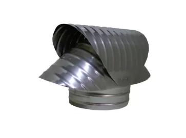

I'm pretty much planning on getting a luxury metals vacuum cap and trying it on the easily accessible liner we have in the masonry chimney which also has the same South wind downdraft issue. If it works there I will get one for the class A pipe. Any thoughts about this brand/type of cap? I'm afraid of potential problems with a wind directional cap.

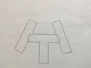

This rig with its surface area seems an unlikely solution in your windy location. Also it would need to set lower than your current chimney section(s) and be braced. Looks are important to you as well. A friend whose father was a tin knocker came up with one for me and solved the downdraft problems I was having with my first wood stove. A local resaraunt has a large one on a kitchen stack. Figured I’d just throw it out if only to add to general downdraft ideas.

Also, I installed the luxury metals vacuum cap on the liner in the masonry chimney and we had a couple days of strong south winds and I don't think it helped. I didn't try a fire in the basement stove that uses the masonry chimney but I could tell there was an intermittent back/downdraft. Some things I wonder about: is the masonry chimney far enough away from the higher peak to the north that it wouldn't be in the positive pressure area? Wouldn't the class A, where it's 2 or 3 feet above the highest peak be out of the positive pressure area? When we were having South winds around 20 mph I started a fire and it back puffed about three times before it got going and never had a problem once hot. Now the wind has switched to the Northwest and we have the opposite problem, too much draft :p
That seems similar to the luxury metals vacuum cap I installed, no?

We solved one of our issues, the windy downdraft, by installing a Vacu-Stak. Of course the day I put it on was insanely windy which was, uh fun, on a ladder. Either way had zero issues and worked perfectly. Now I get to figure non-windy day downdraft issues, but that's a separate problem. I never knew stoves were such problem children to get working right. Makes TP's seem pretty smart.
