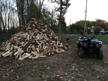

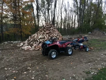

[Hearth.com] Winter of 21’ supply [Hearth.com] Winter of 21’ supply I’ve been secretly cutting and splitting wood for the winter of 21’
I think I have about 4 cords, won’t know until I stack it this weekend
Looks like 3.5.

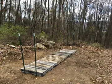

Bringing home pallets to make nice stacks (OCD)

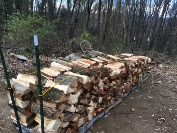

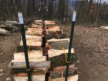

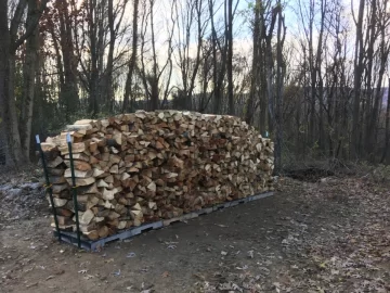

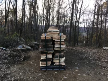

Finally had time to start stacking, this is my method, 2 rows on pallets, I leave a gap in the middle, I use 6.5ft metal fence posts, I tie a rope about half up on the stack, the weight of the wood will tighten the rope keeping the posts stable, I then do a center stack on top so when I tarp it, it will shed water and snow.

Brilliant, i shall steal this when i stack this week

I do it similar only problem I had the first year when it rained the water collapsed the middle. Now I tie the tarps a little tighter.

That's why I have the center dome, the center stack does (2) things, allows the tarps to have pitch so it sheds water, and the weight of the pile keeps the center rows from moving, locks it in and when the wood shrinks while drying the outside rows will lean into the center and not collapse.

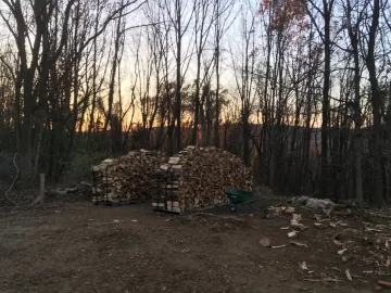

Done!!! Stack 1 is 16ft long, stack 2 is 20ft long. I did some quick calculations and I believe I’m about a half cord short of my 4 cord goal, but not to bad, and I have a few more trees on the property I want to take down as soon as the ground drys up or freezes
So you mean 12/2021? Way to get ahead. Ya, it sounds like you are about close to 4 cords, depending on the exact height. If you are averaging 4' that should be 3.4, while 5'=4.2. Is that red oak? Hard to tell from the pics.
I like the metal stakes and center row, that is definitely time efficient. I have a similar setup in my woods but I cross stack the two ends. One trick I do is to stick a split out about 1/3 of the way underneath each grommet of the tarp. It gives it a little bit of overhang. Probably a better method would be to get 4' stakes.
I've barely started on 12/2020 supply. Only have about 2/3 cord of r oak so far but I'm so full that most of it is stacked on the ground waiting for racks to open up...
I might have bad math, the (2) rows are 16ft & 20ft long, the (2) rows come up 4.5ft and average out to 18" long splits so, 3ft wide
then it gets whacky, the one row has the center kicker @ 15ft long and 16" high, the other is 19ft long @ 2ft. It might be close to 4 cords, the more I look at it, and then look at my shed bays I think I might be close to packing it full.
The mixture is red oak, cherry and ash.
I really like the idea of the rope tied halfway up. I think I’ll try this, should cut down on number of t-posts I use.
