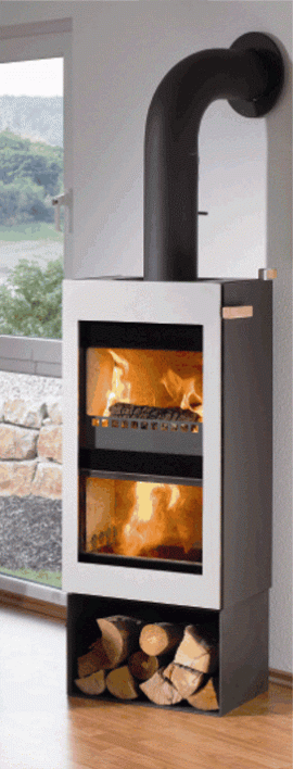

The Twinfire lower chamber is vermiculite, you can see it in the pic.
  • [Hearth.com] Wittus or xeeos Twinfire
Yes, last I heard. I was thinking of eliminating the front glass and the heat loss from it.
Perhaps, but the glass is a better insulator than steel. I wouldn't want the secondary visuals covered up on mine. And remember, that is the ash chamber too, so you'd still need access to it...
