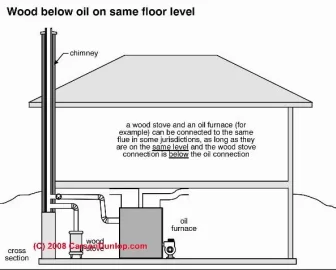

Check with your fire marshal and insurance company, but around here you can have both in the same flue as long as the oil enters above the wood. The idea is that if the wood plugs up with creosote than the oil will remain unrestricted.
That would make it easy. NH code refers you to NFPA 211. Which states you can only put both in the same flue if the solid fuel unit is designed for it. But the Econoburn boiler I am looking at specifically tells you in big letters not to in the manual.
I think the direct vent method is a good option for the oil. Hopefully I won't use the oil very much and I can vent it out next to my chimney where there are no windows nearby.
I guess that makes sense where as most gasifiers use forced exhaust which could re-enter through the oil burner
