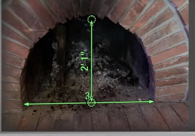

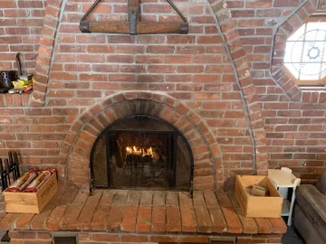

I have a brick fireplace at a cottage that I would like to add a wood burning insert to. Its a weird half circle opening (3ft wide by 2.1ft high) and the cottage insulation is average to poor. Main room and kitchen are open concept with 20ft ceilings, this room is about 600sqft. There are also 3 bedrooms that have regular height ceiling. The whole place is about 1100 sqft. Currently using electric baseboard heaters and the current fireplace to heat it. I have been researching inserts and really like the Pacific Energy Alderly T5 and hope it would be enough for my place. I will need to shave off a few bricks at the top of the opening slightly to make it fit. I like the larger viewing window and that it is non cat. I am just looking for advice or anything to think about before having it installed and if you think it would be a good choice.
