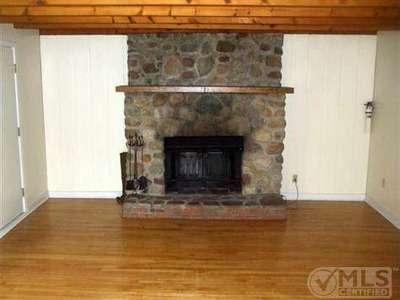

We are closing on a house that has this old wood burning insert in the fireplace. The insert doesn't have a SS liner, it just vents into the existing clay tiled flue.
I'm starting to look at what would be a good, updated insert for this fireplace? Keeping it under $1k would be great.
Any thoughts?
(those are real stones FWIW)

I can't tell from the pic what kind of insert that is. Whatever it is, it appears that it doesn't draw well by looking at the smoke stains on the stone.
The size of the fireplace is really gonna be the determining factor here, it looks pretty big, therefore most inserts will fit in there. None that are under $1,000 though. The liner will be more than 1K unless you do it yourself and most inserts are gonna be 2K and up.
If you just want ambiance, and/or some supplement to your central heat, nothing that will completely heat your house with it, there are a few small inserts available in that price range. Mostly from Big Box and online, Ace Hardware, Northern Tool. (something in the under 2 cf firebox size like my Century insert). Or keep an eye out for something used on Craigs List.
But you might be better off to start with just the full liner. And use what you have for one season to get some experience and see how you want to go. You may decide to do what you're planning and just get something inexpensive. Otoh, you might decide you want to heat the house with wood and get either a large 3 cubic foot firebox type insert or a wood stove. In the meantime you'll want to get ahead on your fire wood supply.
A5T1, congratulations on the house. I agree with Dave that the first step is probably to line the chimney and keep the existing insert for a season. Just lining the chimney can cost $1000. The first step would be to have a licensed chimney company inspect the chimney and unit to ensure they are safe for burning.

I second the comments of Dave and dafattkidd. From the looks of the smoke stains on the brickwork, it appears that you have what is called a "slammer" install. That is, the insert is just slammed inside the fireplace opening - depending on the existing fireplace flue to vent the woodsmoke. Slammer installs are generally not allowed anymore because code requires one to match the size of the flue with the woodstove/insert flue collar. Except for the largest of freestanding inserts, most woodstoves/inserts require a 6 inch flue, typically stainless steel. The big woodstoves often require a 8 inch flue. It looks like your stove may be on an exterior wall, so an insulated SS pipe is recommended.
Installing a new SS flue is a DYI project, depending on your roof (slope, etc.) Many on this site have installed their own exhaust flues. How difficult this job is depends on your roof (how accessible it is) and how big your existing flue is (6inches by 6 inches -tricky- 14inches by 14 inches - can be fairly easy), and how tall your chimney is. You might be able to install a new insulated SS pipe for $1,000, but $1,500 is probably closer to reality. It depends on the length of the pipe/insulation that you need to buy.
As pervious posters have stated, begin by having your chimney inspected by a certified sweep. You can find one by searching the web for "certified chimney sweeps." The chimney should be cleaned first - typically $200 - and the sweep should look for cracks and other structural defects. It is not a good idea to install a new SS pipe in a defective chimney.
Good luck on your adventure with woodstoves/inserts. You will not regret the journey.
First thing after pulling the slammer out is to get the chimney very well cleaned including on top of the smoke shelf. Then proceed with installing a 6" liner kit and consider insulating the liner. You'll definitely want to do that if this is an exterior chimney. For lower priced inserts I would look at the Englander 13NCi, Drolet Escape 1400-I and Century CB00005. If you DYI budget for at least about $1500for stove and liner.
Before ordering, measure twice and be sure the new insert will fit properly. The other consideration besides budget is how often do you expect to be burning and how large an area are you expecting to heat with the new insert? If the expectation is to burn 24/7 and to heat over 1500 sq ft, you'll need to go up in size if you can fit it in the fireplace.

That is not correct, galvanized pipe is never approved for a wood burning appliance. For a stove or furnace it requires at 24 gauge black or blued steel pipe.
But once the pipe meets the thimble in the wall, it must either be all masonry or Stainless Steel from that point on.
An insert must have a SS liner. Some installs allow for a direct connect, which is a piece of SS liner that is hooked to the stove and stops in the first flue tile. But ideally, it would have a full length SS liner. Never would Galvanized pipe be acceptable.

A stainless steel liner is a must. If you want it done right and not have to worry about anything, install the liner the entire length of the chimney and insulate it also.
I can confirm that the fireplace doesn't have a SS liner installed. I had a chimney sweep look at it and currently working with the seller to get a SS liner installed b/c of the safety issue. I guess I'm surprised by the cost of the wood burning inserts, not sure why I thought they'd be less money. I'll try and get exact dimensions next time I'm over there. The chimney is actually on an interior wall, I'd like to try and take advantage of the thermal mass that's in that masonry. Guess I'll start searching craigslist for a good insert. Any particular ones to stay away from?
It's been said already, but will say it again. With a wood burning insert in a fireplace you need to have a full stainless steel liner installed and preferably insulated and you should have a block off plate installed as well.
Can't tell which insert you have in there from the photo, but it looks like it might be a good one -- maybe a cast iron Vermont Castings with two doors. Of course it wasn't installed correctly with no liner but unless it's damaged or older than it looks (pre-EPA) it could be made to work with a new liner. Am curious why you seem so anxious to replace it right away.

Just a heads up, from the looks of that insert it looks pre-epa and probably has a rectangle exhaust, if it does you will need to get a Rectangle to Round insert boot to attach the liner to the insert. You will need to drill and tap holes on the top of the insert to attach the boot to it.

when I zoom in it looks like vertical heat exchange tubes to me. Make sure it has a box on the outside of those tubes that you can hook a liner too.
