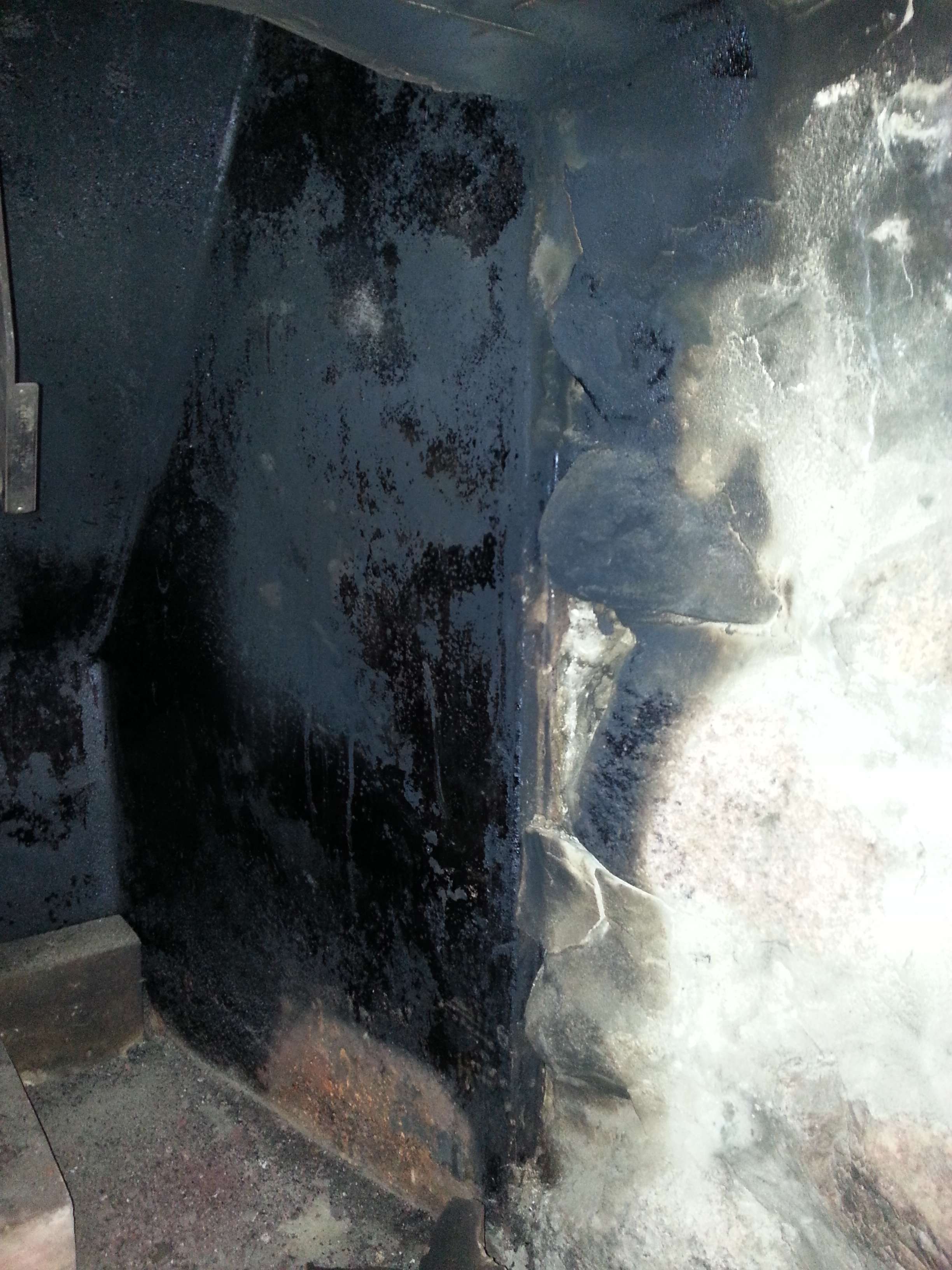

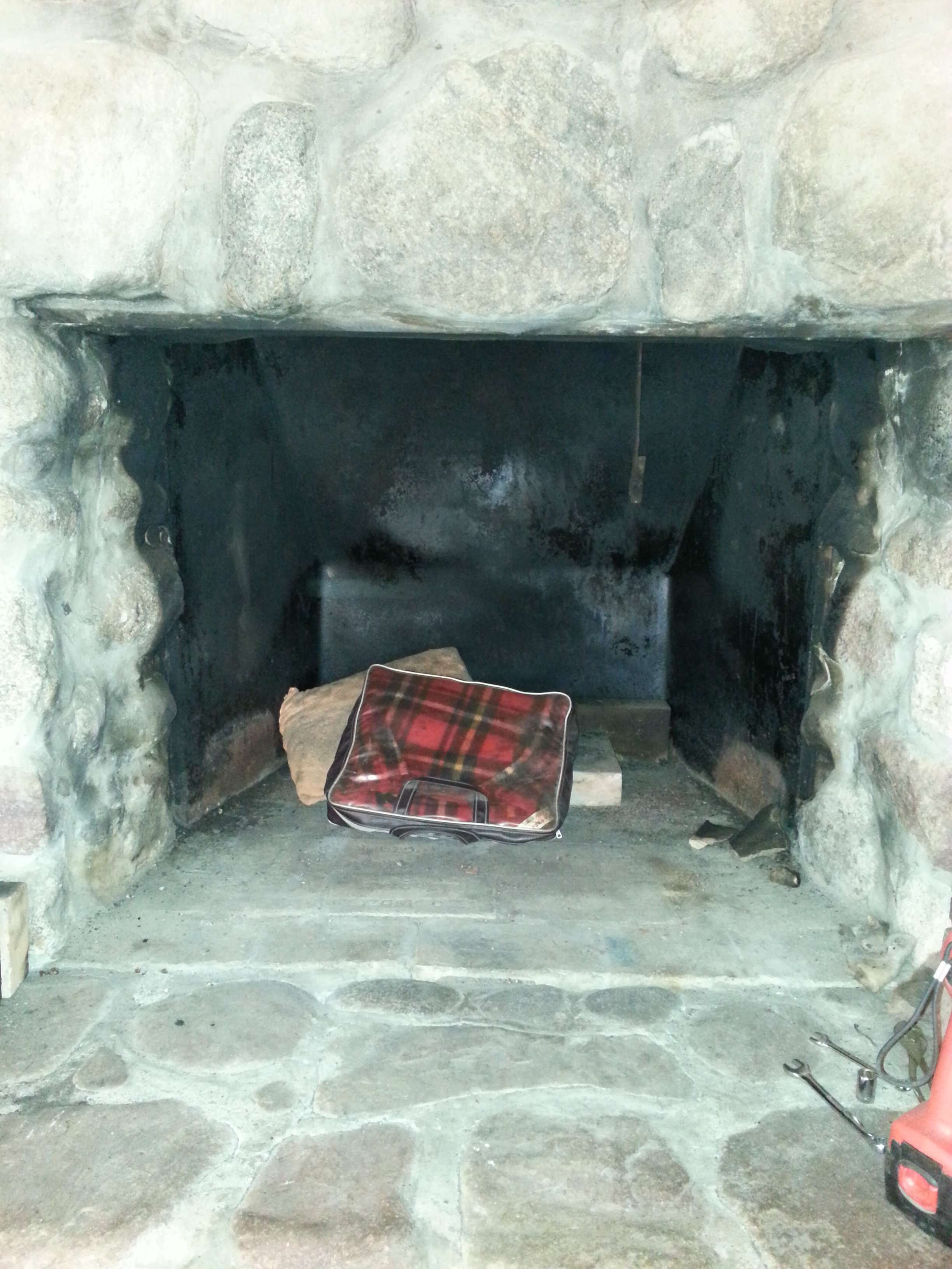

    The plot thickens! The owner removed the insert and there is a heatilator behind it (or part of the insert, I'm not sure. ) Here are some pics. How would you all suggest moving forward with this?
    [​IMG]
    And a picture facing up at the damper...
    [​IMG]

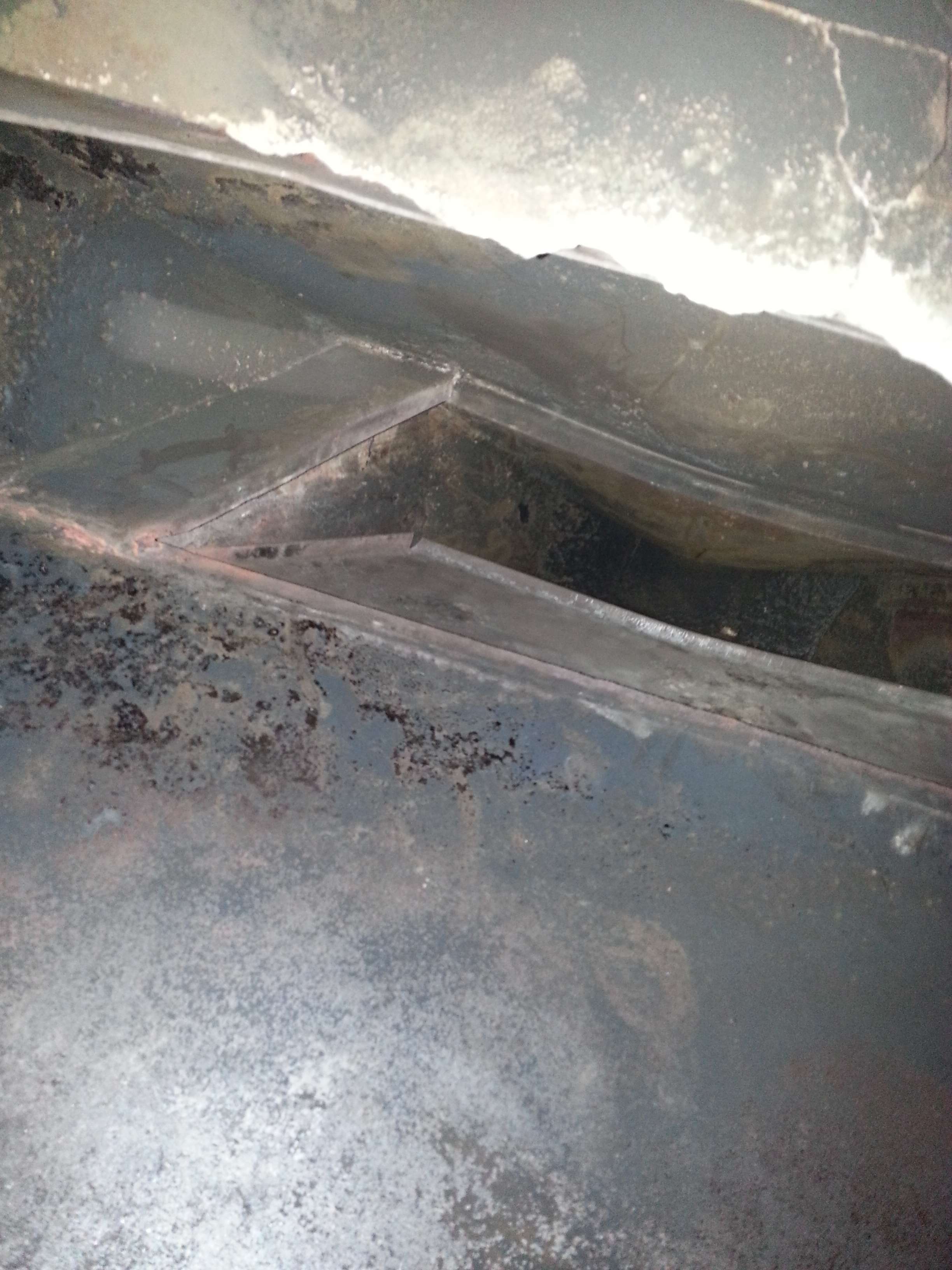

    Some creosotoe buildup?
    [​IMG]

    Nothing out of the norm here. You will have to cut that damper out enough to fit the liner down. Search around on this site, I know there are pics of dampers cut out. That damper looks quite large, is it possible to squeak a 6" liner around with out cutting it?

    After we close on the house I suppose the plasma cutter is going to be used...

    An angle grinder works great also.

    Plasma is a PIA to move around with while in there and getting setup, a sawzall or angle grinder works great.
