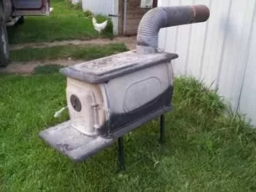

This is the usual picture we see of those nasty things:
[Hearth.com] wood burning stove and CO detector
Reactions: ashleysash

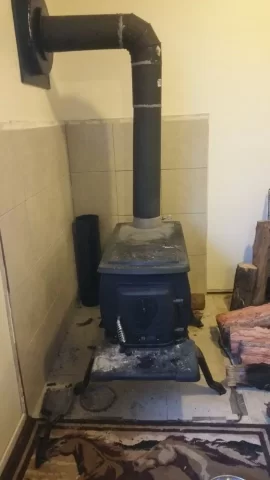

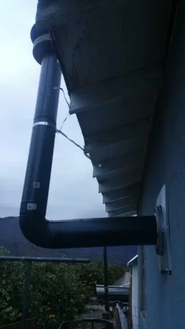

Post some pictures of your setup.
If it looks like a crappy job it's because this rental house is from the 40's and didn't want to go through the roof with it. We are thinking of selling it and putting money down towards a nicer one.

Yup, I sure miss them. Lol. Had one of those in my house when we bought it. I never had a wood stove before that, so it was something to start with... Burned extremely hot and hard to control cause of all the air gaps. Ate a lot of wood and most of the heat went out the chimney with a lot of smoke. Smelled like a campground in and out...

The top of you chimney is way to low to be legal. It should be 2' higher then 10' over.

I'm sorry to say but these pictures look like the headline to the 'Don't' section in a 'Do' and 'Don't' book about stoves.
Holy cow... You couldn't pay me enough to burn that setup. The stove needs 36 inches clearance I believe and it has either single wall or double wall stove pipe run through a combustible wall and acting as a chimney. Don't burn it - buy some space heaters.
There's a triple wall pipe going through wall. As stated before this is our first wood burning stove and my dad did his best to set it up but then my step dad came over to do work on it.
No offence but I have no idea what I'm doing and apparently the two fireplace shops in town and most of my family have no clue either....so instead of saying hey your set up looks like bad and dangerous (which we already knew) how about offering some advice in retard terms on how to fix this? Peaz and thanks! I've heard you want to go past the peak of the house, ok fine how much past? and is there no point to persuing warmth using a wood burning stove if we can't go through the roof with it?

What the hell happened to that thing lol
Overfired one to many times, easy to do with those box stoves, yours is starting to turn white at the collar.
As to configuring it correctly many things will be needed, but to get an idea you can use the chimney configurator from ICC to get an idea on a correct through the wall setup: http://www.icc-rsf.com/en/chimney-configurator

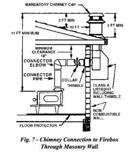

One needs to respect the heat that this stove can produce, especially if it runs away and overfires. There is some evidence of this already on the top near the flue exit. The tile wall is not a proper shield. To be a proper wall shield it needs to sit on 1" spacers and be open at least 1" on the top and bottom to allow air to circulate behind it. There needs to be chimney pipe outdoors. Regular stove pipe is not allowed. It corrodes and rusts too easily. Here is the rule for the chimney pipe height relative to the roof. (click to enlarge)

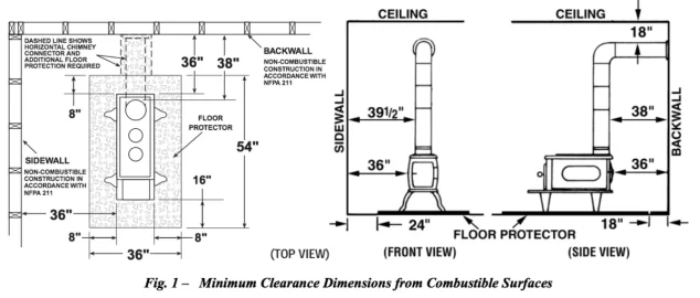

Search is good, but there are site specific problems you may or may not find the answers to. Proper chimney installation is covered in the manual. That is a good thing to read. It's short and to the point. For example here are the clearances and chimney install.
