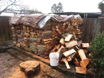

Clearblue, I'd like to see a picture of this cube. Just curious.
so the front width is 8 feet, the depth is 12 feet and the height is 6 feet...typical 39 degree rain and wind day out here! it does get wind where it is and the sides stay dry for the most part unless it is driving rain.....the split wood piled on the side is going to go somewhere else.....all that will remain is the cube....if i clean up the rest of the yard i don't think anybody will even notice it on our summer b-que days! thats what i tell the wife
It looks to be stacked kind of tight. Hope for a sunny, windy summer.
You could always buy some lattice to make a movable screen for those BBQs.
Looks like young doug fir mostly? Fir seasons fast. Maybe work your way around the outside as you unbuild your cube next winter, and give the inner layers some seasoning time.
