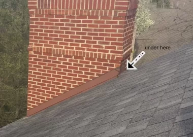

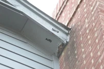

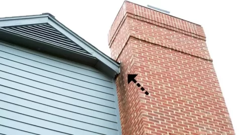

I noticed the fascia/soffit immediately next to chimney wall is rot out.
Please see the picture here:
[Hearth.com] wood (fascia/soffit) immediately next to chimney wall is rot out
I have two questions hope you can help:
1) I am going to hire a guy from angie's list. who should I call to fix the wood rot: roof guy, gutter guy, chimney guy, or other?
2) should I redesign the chimney counter flashing: either direct the water toward downslope, or extended the flashing over so that water will not drip on the fascia/soffit? Thank you very much!

Honestly the flashing doesn't look to bad at all and it looks fairly new. The flashing may have been fixed due to water issues but the rot wasn't. It does look like you could use a diverter though I see evidence of water running down the face of the chimney. It should be diverted back onto the roof to avoid that.
It is hard to say from that pic though there could be a flashing problem.

Hi @bholler,
Thank you very much for your reply.

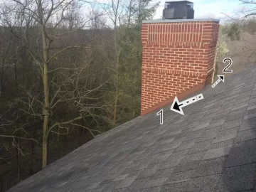

I wish I took a better picture when I am up there. basically the water run into two directio
1) down slope to north side
2) to east side (where the rot happening)
How can I divert the water.

Not a "kick-out" you need as that not a fascia with gutter. (Its a verge rafter (like fascia rafter, if you please))
What you need, is the flashing to be angled, so as to have all the water flow back onto & down the roof (& dressed/folded nicely so it looks good from the ground). A half of a saddle-back. Proper term being 1/2 of a cricket (which you almost never see these days, as current builders, just don't know how to do thinks right -- or don't care, or get paid by the sq.ft., so the sooner they are done the sooner they get paid!).
Yes, just a raised piece of metal, (like a drip edge) that tucks under the shingles at an angle that allows the water to run out and around your chimney, not right into the edge. Hope this makes sense.
How old is your house? Two potential problems regardless of flashing. The wood used on newer homes doesn’t last the way it did on old homes, the end grains abutting the chimney exposes it to moisture and it just isn’t going to dry out quickly. If the flashing is leaking than that makes matters worse. Also any insulation adjacent to the chimney should be removed, it’s just going to absorb moisture.

Thank you very much for your reply. the house is 20 years old, I plan to change the roof this year or next. With that wood rot, I might consider change roof sooner. One thing I'd like to clarify about "any insulation adjacent to the chimney", what kind of insulation could exist between the fascia/soffit and chimney wall?

do you mean add raised piece of metal, so that all water will flow in direction of 1, instead of 2?

Twenty years isn’t bad for today’s wood, which would include wood used 20 years ago. Do you have insulation in your roof or ceiling. If you have cathedral ceilings insulation may be between your rafters and possibly your soffit. One of those pictures looks as though batt insulation is exposed. If not and the soffits are hollow then no worries.
Yes hiba direction 1, out into the center of your roof, keep it as far away from the chimney flashing as possible. I would also look for some bad caulking (probably gone now); by that I mean caulking that was installed in an ill advised way thereby keeping water trapped and not letting the area dry out. It's like caulking the inside of a leaking wall, that water has to go somewhere.

Thank you for your suggestion. From ground, it's hard to say if it's batt insulation, I am going to hire someone to take a look. When the roof so high, everything start to get complicated. :)

That roof doesn't look to bad. Still laying flat. If the roof has more life I would fix up that area with a cricket to run the water downhill.
All you need is a peice of metal like sodbuster said to divert the majoity of the water coming doen the roof back doen the inside of the chimney and down the roof to the gutter yes doing half of a cricket would be a little better and when you reroof you might want to do that but the metal will work fine. And yes new growth wood will not last as long with water leaking onto it. But if that flashing is good there would be no issue.
