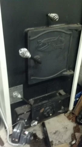

I have an energy king 480ek and it always smokes when you open the loading door. Also it takes forever to light. Any suggestions? Or more info needed? Please ask....Thanks

not sure on your energy king but i know mine seems to smoke more when the chimney needs to be cleaned or when the chimney is cool. Sounds like you're not getting a good draft for some reason.

I do think the draft is a big problem. But I can't understand why. As for the chimney, it should be ok i hardly use this thing
is it tall enough? 3 ft above any peaks within 10 ft? how many angles do you have on it as it goes out?

It is one foot higher than the peak bet its 12 feet away. I did try adding another three foot piece...same result...I have a T in the back of the furnace and two 45s...rest is straight. Insulated pipe outside...black pipe inside.
You must have blockage somewhere, maybe inside the stove? That knob/handle on the front is a damper? Maybe it's come undone and stuck closed? As far as lighting - After a lifetime of paper & matches, this year I started using a Bernzomatic torch, propane, life has never been easier - You still need some small amount of kindling, and dry wood too, but it's blazing in half a minute.

Today I'm going to check the flue. The slide damper is working. It takes like an hour to get it started. I even use diesel fuel too. Last night the flue temp was 400.....opened the door smoke was puffing right out. Its like it has no draw
how long have you had this furnace? did you get it used? sure sounds like you have a blockage somewhere in the chimney or in the furnace itself. Is the cap on the T ?

Ditch the magic heat! Not only do you have a short chimney, that magic heat is robbing draft. In all reality, if that furnace didn't have forced draft, I don't think it would burn well with that setup.
Also try loading when you have a coal bed. Loading with a burning load is only asking for trouble. Once the load is down to coals, there's going to be little to no smoke.
Also, don't assume that the draft is good if smoke exits the chimney. A good draft would allow you to load without any smoke spillage, especially with a bypass.
Yes - get rid of that thing in the pipe NOW.
While you're doing that, clean the entire chimney NOW.
I might have missed it in the vid - do you shut the forced draft fan off before opening the door? If you don't, you need to.
And your chimney might be (is likely) too short.
