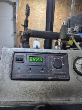

New Hampshire
I have an Orlan eko 40 with a rk2001u controller. The "start" tactile switch is going bad. I called New Horizons and it appears that they are out of business or being sold.
Does anyone have a fix to this issue.
Does it come apart like a key fob button? Maybe you can clean it. If not, that keypad would need to be changed. See if there is a part number. You might be able to use another one if you can match it.
