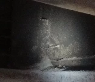

    I have a fire in at the minute but I will get some pictures for you tomorrow. Basically it is a piece of 2" by 1/8 flat bar 10 inches long which covers the opening on either side of the back of the firebox which causes the heat to rise and heat the plenum. I have another piece of larger steel welded on a 90 degree angle to fit in the slots on both sides of the furnace to keep the plates in place. I have also found with this furnace you can't shovel all of the ashes out of the firebox or you will not get any heat either. I keep the ashes just a little below the door or flush with the door. If you go below this the only heat you will get is warming your hands with the door open.

    Sorry about the quality I have been burning briquettes the last week or so and they are a bit ashy. image.jpg

    I actually called the newmac rep and had a long chat with him... Long story our model is an old beast but he did have w few suggestions and I think they helped
    Load wood towards the back and pull ashes to the front near the door
    Also recommended a 1 inch steel plate with holes drilled in to burn on ( as we have the grates ) and we were losing our hot coals down to the bottom
    Run inducer fan and drop the damper down
    Make sure the fan is on automatic as we had It running constantly on manual
    Mode and half the time it was blowing cool air as it was not allowing the heat to

    Try out the plates in the back of the furnace. I guarantee you will find a major difference. I open the draft on the furnace until the wood gets burning really well and then shut off the draft completely. I have not had any luck running the fan all I found it did was blow the heat out of the furnace and reduce temperatures. Without the plates I would have to run the draft a little less than half just to get the plenum hot enough for the blower to kick in and man did it eat wood. Grab a temperature gun and read the temperature on the duct work just above the firebox. I was only getting 70 degrees before I added the plates. The reason I mentioned leaving the firebox full of ash is the heat is being sucked out of the furnace. The closer the fire is to the top of the furnace the more it will heat the furnace and the less time it has to be sucked out before it has a chance to heat. I have been thinking about trying a plate across the top of the firebox near the top of the furnace to force the hot air forward and up to the top of the furnace before exiting. This is how all of the other newmac's are designed. My grandfather has the add on and it has a plate across the top of the firebox and halfway to the front and with just a few pieces of wood it will blow heat for hours. I think the furnace will work extremely well it just has some major design flaws, but with a few small add ons it will work well. The plates are very cheap to make and only lay in place. So there are no modifications.if you have any questions drop me a line.

    Basically you added baffles to the unit. i know some of Newmac other multi fuel units have them in it. I am suprised this unit did not. Thanks for the info.
