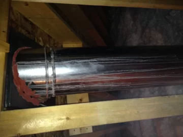

I also just got out of attic taking a picture of my pipe.Hopefully someone can tell me if this is safe for a woodfurnace.ill post what I got

Thanks for the replys guys.Anyone know anything about that pipe in the picture.Its galvanized on the out side and SS on the inside,double wall.
Not me - but I have never seen any chimney or flue pipe that was galvanized, even if there was insulation in between layers.
That's in your attic? Is it that same pipe all the way to the very top? Not something I've seen before - maybe others can chime in. Got any more pics - like of the top/cap, joints, and bottom of it?

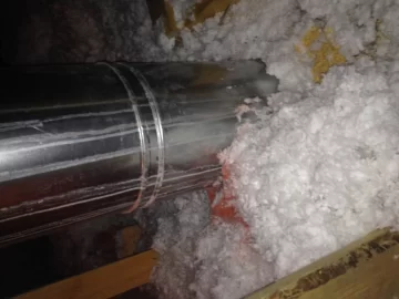

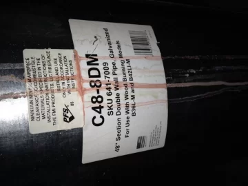

It is made by fmi products.They have two rated pipes like mine,1700* and 2100*.nit sure which one my is made for.Its connected to a wood fireplace made by FMI.heres a couple more picks climbed up in attic again.This the only pipe I can see and it's in attic.same pipe all the way up maple.Wood chase comes out roof about 8 foot and cap is on top.

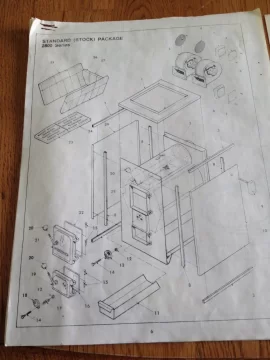

Well took a look at what I thought was going to be a woodchuck buts was a "leaders".It had paperwork and the one pamphlet is actually the woodchuck paperwork.The furnaces look quite a bit a like.was leaders made by woodchuck?Any info on the leaders stove?The firebox was clean and free of rust.Heres a couple pics of the two papers.
