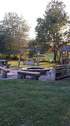

I'm also thinking about building something similar to what you describe. I currently have a burn pit at the far end of the yard (the better part of 100 yards away) but it'd be nice to have an outdoor fireplace and small seating area closer to the house.
Here's the existing one. [Hearth.com] Wood hearth design for outdoors
It doesn't meet your bluestone/concrete requirement exactly, you might google up "pocket rocket stove" made out of a metal six gallon lidded bucket with some stove pipe on it. I also saw a "cinder block rocket stove" on youtube a few hours ago.
