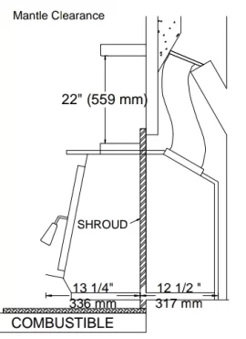

Semiflush means some of the stove sticks out into the room (about 13" for the PI).

I see. I suppose a semiflush gives more surface area for radiant heat to dissipate.
