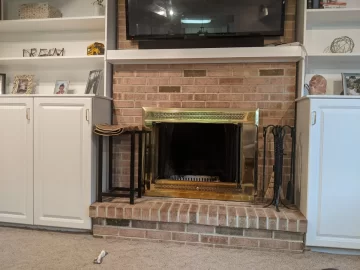

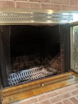

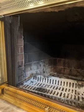

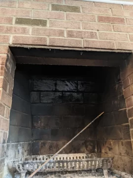

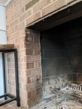

Hi all - I am new to the forum and have been doing a ton of research trying to find a wood burning insert that will work for my current set up. I just got a quote from a local company to install a medium flush mount nexgen-fyre in my masonry fireplace. Does anyone have any experience with this unit - are there any recommendations on a better unit for my situation?
I think I'd prefer to go with the large version of this unit (my house is 2800 sq ft), but my fireplace is approx 30 5/8 inches wide, and the large unit requires a 32 inch opening. The medium unit requires 30 7/8 inch opening, but the seller said they can shave back the brick a little bit or install a reveal around the unit so it doesn't have to be pushed all the way in. Do you think it's feasible to cut back the brick enough to accommodate the larger version? Just behind the face brick the firebox does get wider - 35 5/8 wide (see pictures).
The cost breakdown is below - can I do better than this?
Unit - 3400
Liner w / insulation - 600 (they are including the insulation for free this month)
Installation - 800
Electrical box installation in back of fireplace - 200
Clean existing chimney prior to install - 150
So total I'm right around 5150.
I appreciate any feedback!

Price sounds reasonable. If they are going to cut back the face brick then would the 32" wide larger unit fit? Or does depth become an issue?
I just remeasured the opening and I'm at 30 3/4 in - The medium unit needs 30 7/8in. I think they said they can cut the brick back slightly to fit the unit, but my thought was if they were going to cut the brick at all, just cut back enough to accommodate the larger unit instead. I just double checked the minimum for the large flush unit and its 33", not 32". The seller is stopping out to confirm everything tomorrow so I will ask him what he thinks of that. He said the larger unit is probably 500-800 more expensive, but if I'm going to spend this kind of money I might as well get the size I want. They would need to cut 1 1/4 inches from both sides to fit the larger unit. I'm not sure if that impacts anything structurally thought.
I'm glad they will be doing a site visit. The face brick is not structural. It's the same difference whether they cut off 1/2" or 2".
The site visit went well - He can install the unit in my fireplace without doing any cutting of the brick, but the larger flush mount is a NO GO. He's going to hardwire the unit into my basement through the hole already in the fireplace. The hole currently has a gas line running through it that allows me to easily start a fire in the current open fireplace. This will be the nexgen unit, which doesn't have the catalyst.

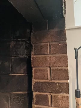

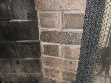

What happened with the idea of cutting back the face brick to gain the full opening size?

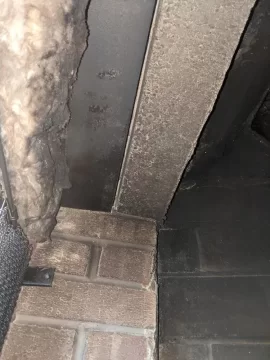

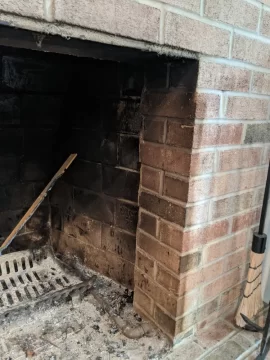

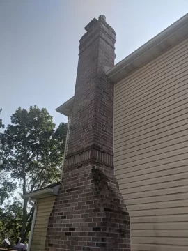

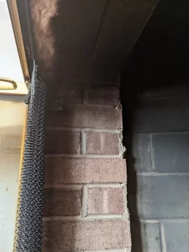

The face brick is 2 bricks deep, and possibly structural. Here are some pictures. What do you think?

Had another chimney company come out and said they could grind back the sides to accommodate the larger unit - I have another place coming out tomorrow so I'll confirm with them as well.
Hope they have a capable vac system! Could get downright dusty.
Will get a few more opinions - I found this place on thumbtack app and i can't find much information on them elsewhere. They have 3 reviews (all positive). They quoted me 2500 to take back the brick, and do the complete install including the insulated liner. I would have to get the Stove.
The question I guess is how wide is the lintel angle iron.
yes that is the question
