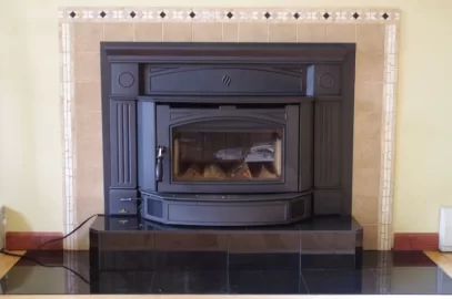

And it really doesn't stick out much at all. Here's a pic right after I had it installed:
[Hearth.com] Wood Insert: Quadrafire Voyageur or Hampton HI300
Both of these stoves are good looking. The Voyageur is one of the nicer looking flush units on the market. Quad makes good products but the flush face of the Voyageur is the main negative IMO. Flush inserts are too reliant on the blower to help them convect heat for my liking. The Voyageur also uses non standard sized firebrick. Treat them nicely or there could be a surprising replacement cost for a new set or be prepared to cut standard pumice brick down to fit.
Hey Velvetfoot...great picture! I am definitely leaning toward the Hampton HI300. A neighbor has one and he also raves about it. I just hit another obstacle though...it looks like the nice wood work diretly under our wood mantel on our existing fireplace doesn't provide the proper clearance. My wife is absolutley in love with the mantel and woodwork around the fireplace (our Center Hall Colonial has wainscoating in the living room with matching woodwork around the fireplace, etc.) If I go with the Hampton, the next step will be getting my wife to agree to ripping out some of the woodwork/mantel to meet the clearance requirements...ugghhhh!!!
