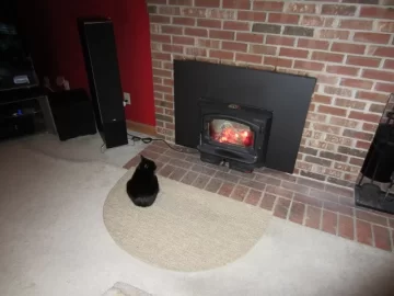

I have an Osburn 1600 which which works very well with the blower off...I rarely turn it on. It has a 1.85 cu ft box and heats my 1600 sq ft cape nicely through NE winters. Sorry for the clutter in the pic (it's warm out we use the space to dry clothes!) but you can see the insert sticks out a fair amount.
This model is NOT 2020 compliant but I'd look into their newer, compliant models.
