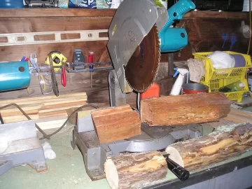

I picked up a used 14" miter saw that will cut up to a 6”x6"and love it. If your miter saw will handle the size of the splits I’d go with the miter saw.
  • [Hearth.com] Wood lenght question
