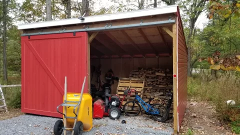

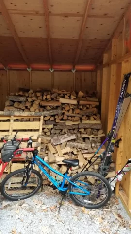

Hi all,
Sorry for the incredibly sluggish reply, heinous week at work last week! Plus, I wanted to get a little further on painting it before I posted photographic evidence. I'd used 3 different colors of tinted primer and it looked crazy!
Anyway, pics attached. The wood is on pallets, which in turn are on crushed stone. Definitely the crushed stone stays dry, but we do live in a fairly wet low-lying area. As you may be able to see the roof is open to the air on either end, and the door is not a tight fit. The doors face south. The dimensions are 12x18, I think around 12' high at the high end and 7' at the low end.
Based on the recommendations above, I've started keeping the door open on the wood side. Thanks for the all the replies, and interested to hear if the pictures will alter things!

I have a very similar wood shed with the following exceptions:
* No Doors
* Back wall is horizontal 1x8's with about an inch of space between each
* Sides are pine tongue & groove siding so far from airtight but looks good from the outside
* I used some 2x12"s from an old building on both sides (inside, spaced several inches from the pine siding) about 5' high - preventing my wood from smashing through the sides.
I found these to be a reasonable compromise - allowing decent airflow but not forcing everyone to stare at stacks of wood. Of course I have lots of other wood stacked outside for people to stare at so not quite sure what my point is:). Wasn't thinking I would ever have this much wood on hand I guess. Then again didn't think I would own 4 saws - things happen............
Reactions: coutufr
Looks like vinyl siding. It is a day late, and a dollar short, but if your walls were wood, the water vapor would pass right through it, eliminating the need for ventilation.
