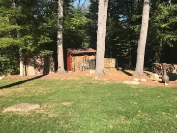

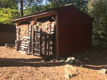

Sorry for the incredibly sluggish reply, heinous week at work last week! Plus, I wanted to get a little further on painting it before I posted photographic evidence. I'd used 3 different colors of tinted primer and it looked crazy!
Anyway, pics attached. The wood is on pallets, which in turn are on crushed stone. Definitely the crushed stone stays dry, but we do live in a fairly wet low-lying area. As you may be able to see the roof is open to the air on either end, and the door is not a tight fit. The doors face south. The dimensions are 12x18, I think around 12' high at the high end and 7' at the low end.
Based on the recommendations above, I've started keeping the door open on the wood side. Thanks for the all the replies, and interested to hear if the pictures will alter things!
Yeah that isn't going to get your wood dry. your shed would work great to keep it dry but it isn't allowing for much if any sunlight to warm the wood and there has to be next to air flow unless it is a windy day coming in the main door.
Semi gloss paint is a vapor barrier.
That's a nice looking shed, but it looks way too tight to make a decent wood shed. Especially if the wood is not fully seasoned before it is put in.

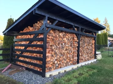

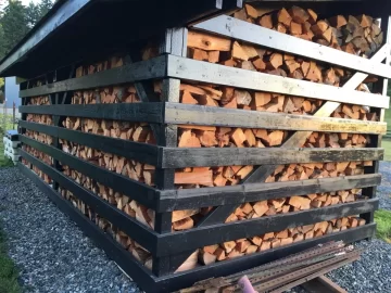

Something of this nature...really what I’m finding is kind of wherever your imagine takes you. As you said a balance between protection yet seasoning the wood. Want more overhang? Make the overhang more. Don’t like how big the gaps are? Make them tighter. Don’t like how small the gaps are? Make them bigger, or use lattice etc. whatever you want! Etc hope that helps.

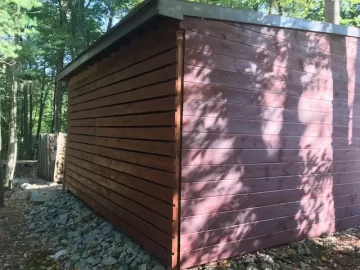

For what it is worth I live in the same basic area as Optimistic and have had great luck with a woodshed that is less than optimal by a lot of folks standards. I went this routs so that my neighbor could stare at a building vs. staring at wood drying, not sure which is better:). In case the design isn't bad enough I stack it tight and I have it mostly buried in trees so it gets minimal sun. I store 2 years worth of wood in it and have never had an issue after 2 years of drying this way. Would be willing to bet that the 1 year side would be more that dry enough as well.
