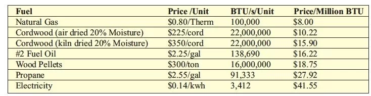

I got this from Woodstock Soapstone. It says NG is cheaper than Wood.
Wow look at the electricity comparison. Glad I kept my trusty oil fired hot water heater and did not listen to the "switch to electric water heater" crowd.
Their calculator appears to assume all burners achieve BTU at a 100% conversion rate.
real world pellet costs would be closer to $25/mBTU, firewood at $15, oil a bit higher depending age of burner
I don't use the new math though so my results may different
