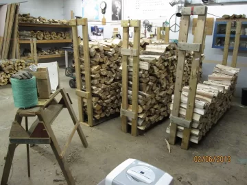

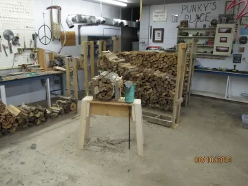

11,000 bundles???? Wow!!!! I've often wondered about getting a firewood bundler/wrapper. I wrap my bundles by hand using 2 straps of sisal twine (around 2200 this year)......
Oops, 1st picture was my old bundler; I've upgraded since then...... :)

Is that the periodic table attached to your wall?
Sure it is... doesn't everybody have one of them in the shop??? Though come to think of it, mostly all I'm working with up there is various stages of carbon liberation.... :)
