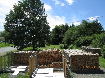

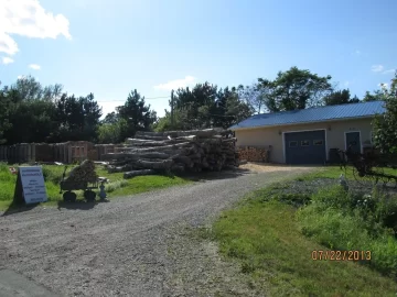

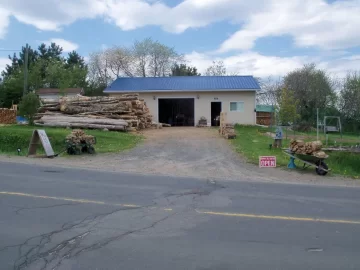

The way I do things now, I start cutting 16" long rounds from my main pile of tree length logs, all the while having to pause in order to lift and haul the rounds to various racks (between the shed and the shop mostly) where they'll sit until I'm ready to start splitting. I usually cut and stack rounds until I have about 3 cord stacked up and I don't have anywhere else to put them. Then I get out my Ariens and start splitting: I fill up a wheel barrel at a time, roll over to the drying racks and stack it, then back to splittin..... So in my ideal world, I'm thinking, hmmm, if I had that little Wallenstein WP830 wood processor I could set it up beside my tree length pile, winch a log onto the deck, cut it, split it, fill the wheel barrel, take it to the drying racks and stack it, and repeat ad nauseum until I be rich......:) The wood processor in this case would supposedly remove the stage where I'm lifting/hauling/storing 16" rounds that will eventually have to be lifted off the racks to be split..... For around 10K, I could easily be talked into going this route, maybe..... I don't know if it would really be worth it though....
Below is some pictures to give an idea of my work area......
