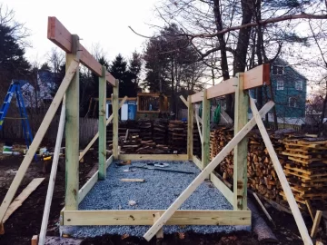

Very excited to finally get this project underway. Started a couple of weeks ago digging holes and pouring sonotubes. Framing started this weekend. Hopefully I will find some time to continue the framing before the real winter hits. We have been pretty fortunate so far.

Looks like a nice start. Look forward to seeing the finished shed.
Looks like your location would allow for leaving the front and rear open.
That's the plan. I'm going to need to reconfigure my stacks but that should be easy once the shed is complete and needs to be filled.
Looks nice! May I ask what are the dimensions?
16 wide, 8 deep, 8 high in the front, 6.5 high in the back. It should give me enough to have one years worth of wood in each bay.

Looks like your off to a good start, how did you notch those posts? sawzall or circluler saw?
looks like a good start. what are you going to use of a roof?
Thanks, actually I used both. Circular saw on both sides, sawzall to finish the cut, then hammer and chisel to clean up the imperfections.

I'm still thinking about that. I wanted to do some sort of metal roof. My wife likes the clear plastic. Do you have any good suggestions?
