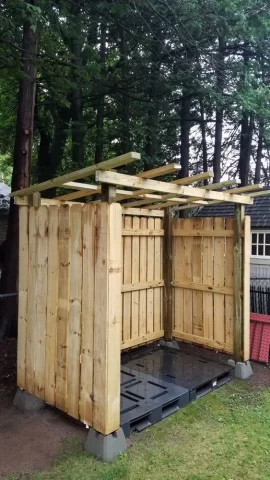

Wood shed built using board on board fencing
Supersurvey
Jan 25, 2015
273
New Jersey
Looking for pictures of a wood shed built using wood fencing such as board on board or shadow box fencing. Seems to be an easy design, basicly mostly pre-built. Anyone ever try this method?
It would seem that once you have the ground prepared and the footings ready, there wouldn't be much savings in time or labor to use mostly pre-built vs. just framing it up and slapping a roof on it.

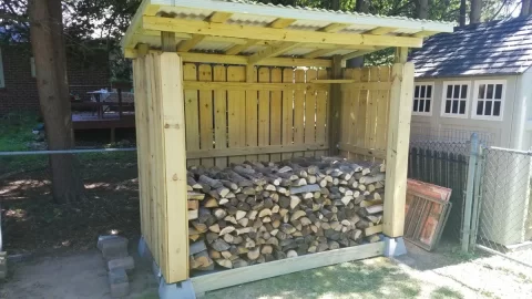

Thanks for the detailed analysis. I love the clear corrugated roofing. I'll post some pictures when i decide on a concept.

Nice. I would have run the roof joist 2x4's with the 2x4's standing up rather than laying down (for extra strength under a snow load) but that'll probably handle whatever NJ can throw at it because it's only 4'.
Thank you, being an Engineer I should have known better but was trying to give myself more play with screwing in the roof pannels.
