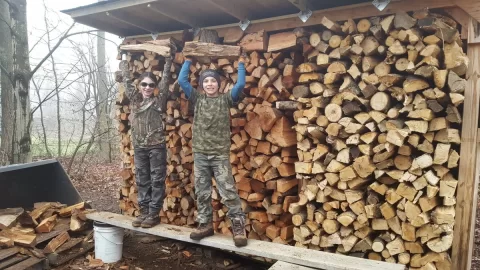

My shed is 8x24, and I honestly wish I had made it a bit bigger. I built 2 little removable walls to separate the shed space into 3 stalls, for 3 winter's worth of wood. I stack 5 rows deep, and up until this year was throwing it right in the shed after bucking/splitting. Never had any issues with rot. One thing I suggest is to ensure you have a good overhang to try and keep wind-driven rain out. I wish I had more of an overhang on my shed, and I wish I had made it a bit bigger. Have fun with the build!

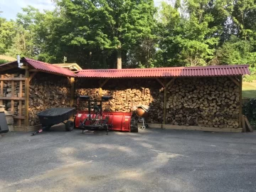

What a setup! I'm jealous. My lot is so steep it's only a few degrees shy of qualifying as a cave dwelling. Stellar stacks!

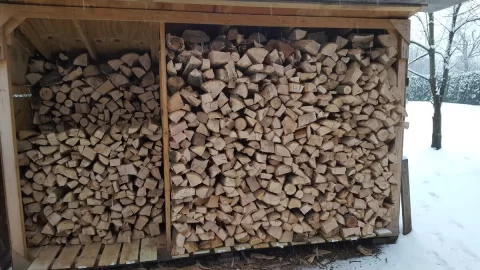

8*18' here. 7.5 ft tall in front, 6.5 in back. 1.5' overhang in front 1' everywhere else.
3 bays.
And yes. I wish it was bigger. But the wife and the town disagreed.

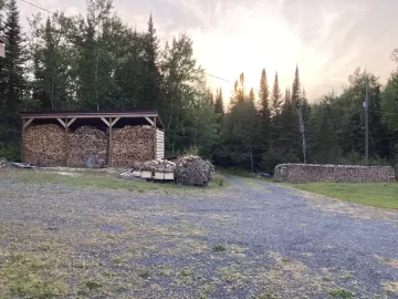

Built and filled this year, so I hope the center will be ok. @Highbeam has something similar but bigger and has used it a long time. No wetness issues on the inside as far as I know.

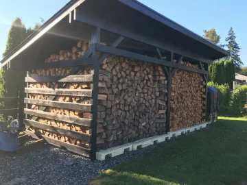

I have had zero problems with moisture in the center of my two 10x10x7 foot bay blocks of firewood stacked tight. I’m in wet western Washington and I split big for a cat stove. I stack it green. Right after cutting it from logs.

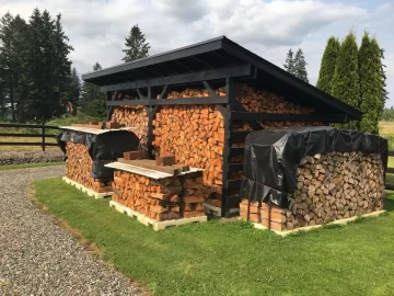

I wish it was three bays but the county limits me to 200 sf without permits. So, like others, I have resorted to stacking overflow outside of the shed.

Bro... look at MissMac go.... you get 4 thumbs up and a fist bump thats a good looking shed and pile girl.. lots of work there

Thanks! :)
Bigger is better as already mentioned. One thing to consider though is how you will stack the wood and then access it for use in 2,3,4+ years. Dividing into bays like above pictures is a great option. Just remember that the oldest wood will be at the back of the bay. Do you really want 7 or 8 rows deep? Will you be filling each bay with same species of wood? Should you size each bay for a full season worth or some other amount? Questions, questions, questions.

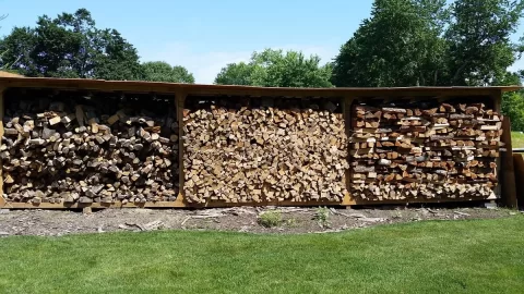

My driveway ends next to a retaining wall on 2 sides, the house garage is on side 3, I build a L shape wood shed with 10ft bays 30ft long x 5ft wide & 10ft long by 5ft wide, I can fit approx 2 cords per bay, have 4 bays total, typically burn just under 4 cords a year so I'm able to alternate and have 1 full season drying under cover for 2 summers before burning providing that I fill the shed up in the spring,
The biggest thing to me that makes a difference it having long enough overhangs, between snow and wind blown rain I've havent had any issues with the wood stacks getting wet.

That's a beauty Kenny.
