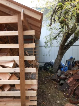

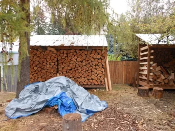

Shed is basically done. Just looking for a cutoff wheel for my circular saw to trim a metal roof panel. Learned a lot from the last shed (shown on the 4th picture) and had the first real rain last night since it was finished.
[Hearth.com] Wood Shed Finished[Hearth.com] Wood Shed Finished[Hearth.com] Wood Shed Finished[Hearth.com] Wood Shed Finished

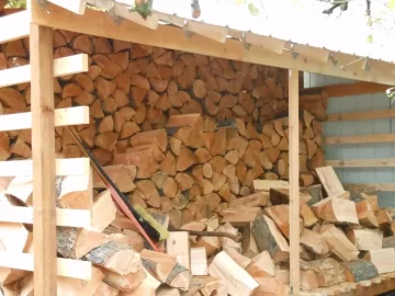

The new rack holds right at 6 cord when full there is just under 2.5 cord in it now. The rest needs stacked but I was in a hurry yesterday to get everything split before the rain showed up last night.

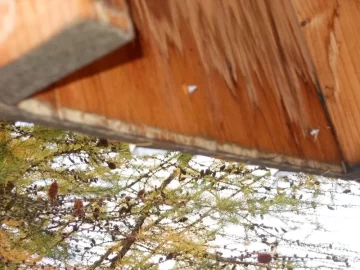

This picture shows something I learned from the last shed. I didn't leave enough metal roof overhanging the edge for a drip edge. That's something I'll have to address soon likely by inserting some flashing under the roof edge and extending it out about 3/4 of an inch.
View attachment 77471View attachment 77472View attachment 77473View attachment 77470
