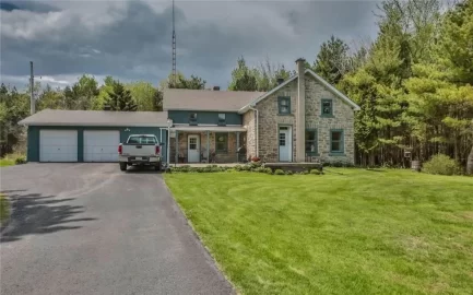

I bought an old 1850s stone home (1500sqft) on 8 acres with electric heating. That had to be taken care of.

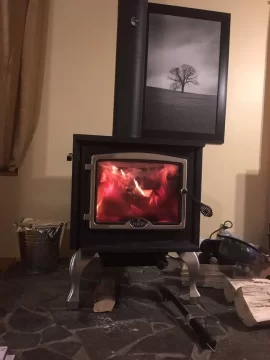

It had a small decorative propane fireplace that ripped through propane and gave off very little heat. It has been replaced by an Osburn Wood stove.

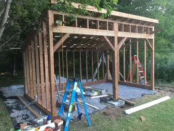

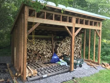

I thought how hard could it be to get my own wood? Well after chainsaws, log splitter and wood chipper, I needed a place to store wood. So my father being a draftsman, drew up some plans and here it is. 16wx10dx9t. Used gravel covered by landscape fabric to prevent dirt getting into the gravel and skids to keep wood up. I have too many other projects i need to do before winter. I will have to hold off on the walls. Left side dry wood, right side.

It might be wise to put a couple temporary boards on the side walls as cross bracing in case you get big winds/snow this winter. It would be a shame to see that beautiful thing fall over before you put the slats on!
Also, it's pretty deep/wide for fast wood drying so consider that when you install the slats/louvers and leave enough gap. Since your eaves are not very deep, the most effective ventilation while retaining protection from wind driven rain would be angled louvers. These take a little more time but about the same amount of material.
Now that's a shed!! Care to share the plan?
Stone Greek revival? Beautiful home and nice woodshed
Thanks all. I appreciate the tips for walls
As for the plans, I never got final copies and there had to be some adjustments to even his final. I can find my copy but it's only 16x8 with a different roof pitch. And can't guarantee exact measurement. We measure 3 times minimum before each cut :p
