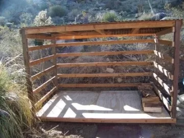

I agree with Jags. My avatar is the wood in my woodshed which is right by my driveway. I made it out of pallets but took my time with it. It looks nice and people always comment on how nice it looks. See this thread: https://www.hearth.com/talk/threads/13397/ In regards to sun or shade, Marty's on target. However, ideally a wood shed is a place to store seasoned wood, not a place TO season wood. Yes you still want good air circulation because it can still season further, but put it your shed where it's conveniant regardless of sun or shade and use your sun location to season your wood before you store it.

Mine is about 10 feet from the end of my deck off the back of the house. I plan on filling it and seasoning it myself, putting one rack full on the back deck, but away from the structure itself.

My avatar depicts my woodshed location (approx. 100 feet away from the house) and in the forest. However,I am able to store a 10 day supply under my covered deck. And when we get snow here it rarely stays on the ground for more than a week. :coolsmile: So depends on your circumstance,weather,wind,etc.
You should note that I`m currently in the process of opening up my woodsheds,knocking out boards on the sides to allow more air to circulate. The air circulation isn`t all that great with trees acting as a windbreak. Something to keep in mind should you decide to go the "forest route"....
