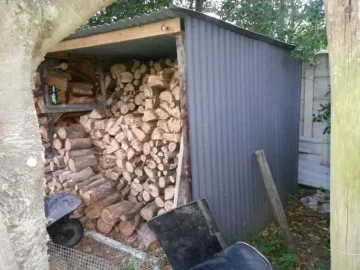

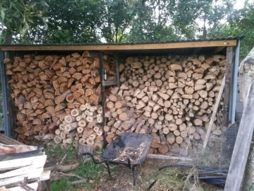

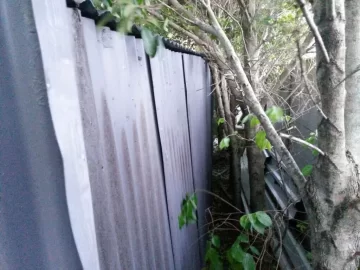

I built this woodshed before I joined here. About 3 years ago. It was build from recycled roof sheets, corrugated iron, and clearly does not allow enough breathing/cross flow.
We have a mild climate here with lots of wind and hot summers. I keep some of my wood in here and the rest are stacked in the open.

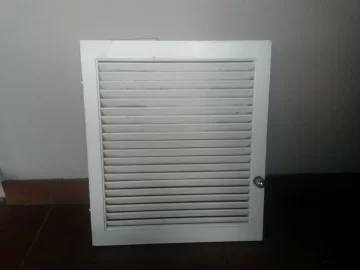

I was thinking of improving the wind flow a bit to get the wood at the back to season better. I have a few of these pine louvre doors. The wind mostly blows towards the back and front, south westerly and easterly. I thought of cutting some square sections out the back wall and fit these louvres since the rain and wind comes from that side.
Will this work or can one cut some slots into the metal wall and make your own louvres?

If you want to season wood in a shed that deep, I'd completely remove the back. If you can though, I'd season wood outside and use that shed to house dry wood. When the stacks are so tight, it's tough for the middle and rearward stacks to get sun and wind, and I don't think those doors would help all that much

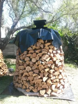

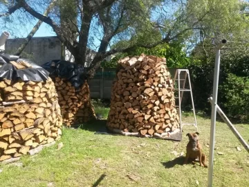

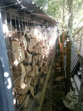

I took the advice and modified the shed. I removed the back wall and replaced it with wire mesh to keep the wood from tumbling out. I also managed to extend the overhang slightly so that less rain water will run down the wood. I managed to complete my 3rd holzhausen as well. I still have enough un-split wood left for 2 of these.
I had a spare chimney cowl which I fitted on top of the plastic to allow some ventilation, if any.
