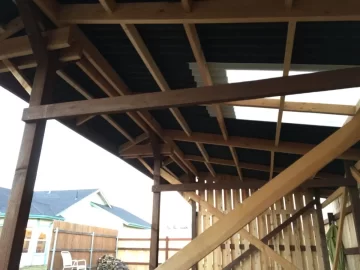

Don't nail the rafters to the face of the 4x4's with snow and really ever. You want your weight transferring straight down to the ground. If the rafters are on the face the nails might pull out.
It's hard to notch a 4x4 to accept a 2x. Your not left with a whole lot of the 4x4 left. If your set on using 4x4 post then look at Simpson strong ties to attach your 2x to your 4x4. They make many different fasteners and some are adjustable for your situation. Or make your own.
I will read this again in a minute and try to digest the rest of what your asking.
This is my covered deck. It's overkill for a wood shed but you get the idea of what I'm talking about above.

Based on the materials you have I would do 4x4 post with minimum of 4 across the 20' span including the corners. I would put a doubled up 2x6 across the top of the 4x4 the length of the 20'. Secured as the pic above or similar.
