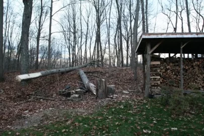

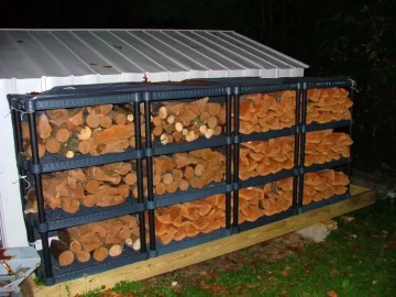

Here is a pic of mine. Its not the prettiest, but it does keep the snow off the wood. The steel is left over from some warranty work on my pole building. The dimensions are 16 wide x 12 deep, approx. 7' high in front and 6' in the rear. I bought some 4x6's for posts and put a few 2x4 nailers between them to hang the steel. I'm no carpenter, but this project didnt take long to build, if I remember correct, I had it up in a weekend, by myself. I left the opening in the front 6 feet wide so I could easily back a pickup in the doorway for unloading. But now I use my bobcat and simply dump the wood inside than stack. I'm glad I didnt leave the front side completely open. I can stack the wood tighter against the sides this way, and it also keeps the snow out.
I hope the pic is light enough, I ran outside to take the pic after reading your post, but unfortunately its dark out. I did lighten it up some. It's about time to start filling the shed up again for the winter one of these weekends. The wood you see in the shed is left over from last year (nice). I'll only have to add about a cord to get it full enough for the winter. Oh, what you see on the upper right corner of the shed is my weather station. Which is broadcast worldwide via internet.

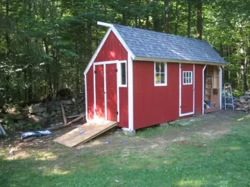

heres my before and after wood shed shed pics. It holds 2 cords very nicely.

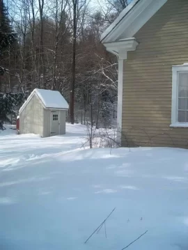

Can't really call mine a wood shed, but it might represent one form of minimalism.... Plastic shelves with a dark grey PVC tarp over the top and back to prevent the worst rain penetration. Seriously though, I do have to keep runoff from that tin roof from pouring into the stack, otherwise nothing will ever get dry. Faces directly south for heat absorbtion. Unfortunately, the ground wasn't level which it must be for this concept to work. The wood isn't stacked very high on each shelf, so no stacks falling over and it doesn't look too bad either...

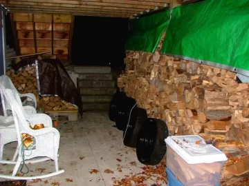

Here is the dry wood under my deck where it is easy to reach even in the worst weather. I would like to fit a metal roof under the deck, that way the tarps wouldn't be required and it would meet my wifes critical view as an "achitectural feature". I have a complete loop of 1/8" cable near the top of the 6x6 posts over which the tarp hangs. That way I don't have to fight the tarp when trying to get wood out and the tarps look nice and even. At the bottom, the wood stands on those 2x2' "dri floor" plates that have the dimpled plastic underneath to block moisture. It is not clear to see, but at the bottom the stack is 28" deep and at about 4-5ft it goes to just a single 14" width.

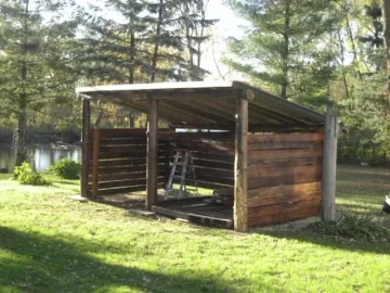

I followed plans found on the net somewhere for a "rustic" shed - saved a lot of money on the beams/posts but it was def. a pain in the butt. I also used 2nd grade cedar shingles instead of asphalt which ran me $60 or so; then about $100 in sheathing / tarpaper / 2x3 roof joists that I purchased. Involved strapping the crossbeams to the posts and then raising the very heavy assembly with a cable hoisted through a tree. However, I expect it to last a long time as the posts are fairly massive. It holds about 4.5-5 cords and has survived a couple two foot snowstorms without any evidence of trouble. If I did it again, I'd slope the roof a bit more.
I also set the posts on flagstones and the ends of the posts are sitting on tarpaper scraps. I also spray the ends with an insect killer once a year to make sure the ends don't rot or get eaten. After a couple of years, they look like the day I cut them - hopefully they'll last a long time as I don't want to do that again anytime soon.
-Colin
(picture is from taking down a huge poplar next to it... sorry it's not complete - someday I will get a better photo)
-Colin
It looks like we followed the same plans!
Your right...it was a pain in the butt. You say if you did it again you would add more slope/pitch?
Mine hasn't seen snow yet, so I dont know????
What are the dimensions? Mine is 8X16. 7ft in front and 5 in back.

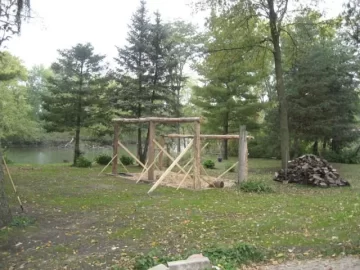

Yes, I did pick good stright beams and post. I live on a lake, and the island behind my house/cabin has standing dead trees-with bark already off.
On the front section (and rear for that matter) I made a jig in the driveway to simulate the posts the beams would be sitting on. This allowed me to level it, according to how much I would have to hew out the beams. Then I moved them to the site, and strapped it with metal strapping, and added two Barn pole nails to each beam and post. Then I just had friends come over, and with a person on each post we lifted it level.
I found the tricky part to be the roof. I would hew out a section for the rafter only to find I needed to build up elsewhere.
Here is what the intial frame looked like.
