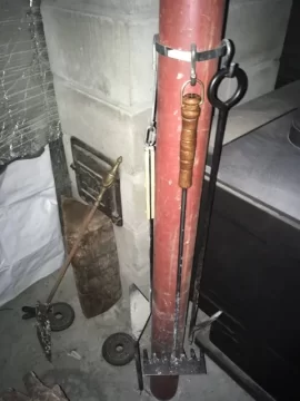

The clean out is 18” off basement floor, same level as stove door. Thimble is about 5 feet up on chimney...

Yes insulated steel liner. Latch catches on but not by a lot.

Thinking of taking a file to the latch and making it a bit deeper as to seat better

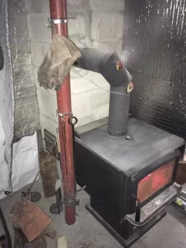

I've had that happen the last 2 mornings. First morning smoke was pouring in the house and I could not get it to draft. I ended up pull clean out cap off bottom of T and it started drafting. I had a window opened up stairs and thought that was the problem but I made sure everything was closed up this morning and I was getting a little back draft. I checked draft with a lighter. I ended up lighting a piece of a starter stick and it took about 2 minutes but chimney started drafting. I'm not sure if it's outside pressure? I have never had this happen, which my stove has not been without a fire for a couple months until recently. The big lesson for me is to check my draft before lighting the fire.

Nope. No cap. The stainless liner ends at the clean out.

I'd get a cap on the end of the liner. That could be the issue right there.

Flue system for the stove should be tight with no air leaks. You want the draft to be pulling only from the stove. Leakage in the flue system weakens the draft and can excessively cool flue gases.
Makes sense. Thanks for staying with the post.... Guessing the bead of silicone around the clean out door may be easier to remove to clean out each year, and would seal the door from leaks and the occasional downdraft. Would love to hear if others have a cap at the bottom of liner with a cleanout door. My liner ends a bit up from the door so adding one now might be tricky.
I would cap the end of the liner. Then the clean out door won't matter. There may be other leakage in the chimney that can feed air into the liner.
