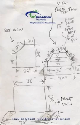

PS...The top of my fireplace goes back 26" from the face of the fireplace to the back. The top goes straight back 20 inches and then drops down on an angle for a distance of 20" ...That 20" measurement slopes quickly, and accounts for the addional 6" in depth ....I don't know if I'm explaining myself well ....I should post a drawing but I'm a newbie and don't know how ...I have to read more on the forum structure ....????....Jim
Easiest way to do drawings and such is to make them in your favorite paint or drawing program, then save them as JPG files - if need be shrink them to no larger than 640x480, and post... If you have a CAD program (and there are free ones on the net that do a pretty decent job) then you are that much ahead of the game.
Gooserider

Hopefully this JPEG will post
This is a rough drawing of my fireplace ....The bottom shows a the openning of 36 x 28 with the hearth in front ....
There is a view look down on it with the flue openning and there is also a view from the side .....Jim

The sketch is helpful, though I will let Corie and Mike answer on fitting the stove into the FP since they know the things better than I do.
It does seem likely that you will need to extend your hearth though. Code now requires 18" (or more) protected floor area in front of loading doors, although some inspectors are allowing less in "legacy" installations (talk to your local inspector for details on what he'll accept) I think going extra wide is good for safety. This doesn't have to mean sacrificing floor space or adding a "toe buster" hump however. It is possible to do a "flush w/ floor" extension in front of the existing hearth - remove the existing carpet or flooring, and possibly some of the subfloor, and then build back up with a layer or so of Durock and some ceramic or stone tile. I just did this, and ended up very close to flush with our existing carpeted floor, looks great and seriously exceeds code.

Gooserider ,
Thanks for your input ....I agree that the hearth has to be extended ... From info here on the forum, ANY stove that I buy will need to have a minimum of 18" from the front of the stove to the front of the hearth .....Thanks again , Jim
