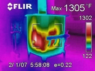

I'm not looking for any government handouts, but I do expect our government to help protect the small businessman from being required to perform testing that is only affordable to large corporations? Then they tell you where you have to have it done? What a rigged game and before long every small businessman in this country will be driven out. You'll buy all your stoves from Home Depot, Wal Mart, Lowes, Microsoft, Exon, and maybe Sams Club. This country was not founded on large corporations selling nothing but imported junk and something has to be done for small business. I may go under with this motto, but I'll go down feeling good about myself. There are still some citizens in this country that would like to buy a QUALITY MADE US PRODUCT AND ARE TIRED OF SUPPORTING THESE HUGE CONGLOMERATES???
We're talking about particulates in the air for woodstoves and all kinds of fancy gas numbers that don't mean anything to the regular consumer. They want something they can understand and that's simple descriptions. Catalyst stoves are just like our auto's here. Why not burn the fuel completely to start off. If this process is done without all sorts of fancy numbers and over engineered devices everyone’s skeptical?? I for one refuse to fall into this mass paranoia and think that things have to be over complicated to operate efficiently. I am an engineer and have seen what this does to products? You take a simple product that works great, but that’s not good enough? We must change it drastically over the period of years to keep up with the competition, (Microsoft Vista)?? What ever happened to sticking with a good product? I worked with a company that sold Medical and Dental Sterilizers in the 80"s. They had a great product but that all had to change, as it was the digital/microprocessor revolution. So we took the simple, reliable product and controlled it with digital electronics, instead of the components that worked great for 15 years. Guess what? They were way more expensive to make, and broke down on a regular basis, as mixing digital electronics and 300 F steam didn't seem to work for some reason?? The company went bankrupted over this stupid idea that all devices have to be massively complex to work well be efficient.
I found a product here in the Sedore Stove that does a great job of heating large spaces, on very little fuel. Now if that doesn't add up on the exhaust gas engineers spectrum analyzer, or better yet there is a possibility that it might not, so we'll assume is doesn't until it proves itself. Personally I found it comforting to find a product that has the ability to heat your home, (Furnace, No EPA listing required) with a wide flexibility of fuel options, simple to operate, hand made in the USA by a small company. Hopefully others will feel the same and maybe I'll make it?? But if everyone is a professional skeptic and won't give a product a chance, without even seeing it perform, I’ll at least have the satisfaction of knowing I did my part to produce a quality USA Manufactured Product, that was amazingly simple and versatile, and I gave it my best shot.
Sorry I got on a roll there please don't take it personally,
