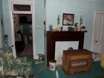

Original listing with an ancient gas heater seated in front of the coal fireplace. Want to put a wood furnace there, vented up chimney.

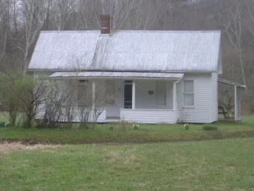

Not to derail my own thread, but here attached is the place. 40 acres of mountainous woods at the left, and 10 acres of pasture to the right ending at a 20 foot wide X 2 feet deep medium flowing creek. I'm so far back in the woods that I get NO mail delivery or snow removal, so I can't rely on the propane man filling a tank in winter. And the electric power is unreliable. So its wood. No other option. Wre love the working 1919 hand pump on the side porch.

Those are called transom windows and they are not ancient lol. They are actually very helpful in distributing heat. Can you show a floorplan we may be able to give advice

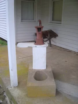

Is there running water in the house?
Yes, there is running water in the house. And a functional hand pump outside on the side porch for emergencies. Satellite only for phone service, internet and tv. We have a small solar setup (10 ft x 10 ft) for critical functions (phone, internet, lights, and meat freezer). We'd use the big creek for hydropower if it didn't freeze up in winter :(. I literally had to photograph the power meter to get the power company to believe there was someone out here to turn on my power. The roads may not be passible in winter. So we really need wood heat to survive here.
From looking at the width of the tin on the roof, the exterior of the chimney is 18 wide give or take a couple of inches. If you subtract the width of the bricks, the chimney most likely has an opening of less than 6X6 where the two fireplace intersect. I am assuming from the discription that there are two fireplaces, not one that is open on both sides.
That place screams for a new prefab insulated chimney run straight up. A flashing would tuck under the ridge cap. Straight pipe is cheaper than elbows. It might seem daunting, but if you are going to live there, this will eventually seem like a minor project. The double wall pipe going up the chimney that you are thinking of is going to entail more work and not less money than an insulated double wall prefab chimney.
Count the bricks across the chimney. They are about 6X3.5. You have two long sides and an end going across. That should give you a good idea of the interior and exterior width if it is clear top to bottom.

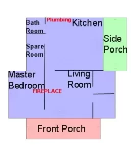

If you can post a sketch of the floorplan then we can help think about how to best improve heat circulation. This is not a large place to heat. Once heat loss is addressed it should be pretty easy to keep at least the core of the house cozy.
