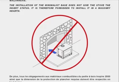

The inspire 2000 is made BOTH as a stove and as an insert (2000-I). The minimalist base option (1" thick?) makes it really low. Attached is a photo with the soapstone base option. 2.4 ft3 firebox.
Thanks for posting the pictures. Is this sold in the US? I visited the official Osburn website twice looking for it, but didn't see it listed. Then I searched on the model number that was in your posting and that brought it up on a different site. This still doesn't solve the issue of trying to run a top vent stove with an elbow right off the top and then going horizontal to a short chimney liner. This is will not work well.

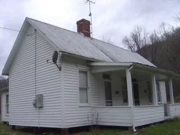

I would disagree on the total chimney height of your estimate. The ceilings are measured at 10 feet inside and the attic looks to me to be another 9 feet. With the chimney around three feet above the peak, I'd guess that it is 21-22 feet. That isn't high enough for decent draft? I see lots of online installation instructions with exactly the same setup (90 degree elbow, horizonal pipe, T, and upward liner. Here is another photo of the house and chimney. The stove in question is available in Tennessee (eFireplace).
By counting claps that to me look like they are about 5" that tells me you are about 17 from the bottom of the siding to the peak. Add 3 feet for the chimney you are at 20. Then subtract the thickness of the floor and the height of the stove you are back to around 17.
