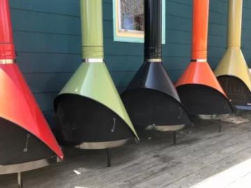

So I have thought about this some for my own porch. The elements will be pretty rough on some other get hot and then gets exposed to moisture. Something like this with a finish that won’t be harmed by the elements is a thought. More fireplace like and less stove like. Thinking a chiminea but suitable for the space. I’d wait a year before putting in a stove and see how you use the space. I have seen several porches in Maine that became 3 season rooms at considerable cost. That might change my feelings about what type of stove as I would be less concerned about corrosion. Just some thoughts.

Thanks, EbS-P. Those look great. Something like that might be the perfect solution but the ones made for outdoor use don't seem to be designed for a through-roof chimney. Not sure how tricky it would be to fit one.

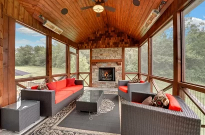

Go with an outdoor open fireplace. You'll get the ambiance and radiant heat. It will withstand the elements better. I'm afraid a stove will get rusty rather quickly with humidity, rain, snow....
You may want to look into propane or electric radiant heaters too like you see in some restaurants mounted on the ceiling. See picture below of literally everything i just said :)

We used one of those radiant heaters in a shop it with through a lot of propane we had 2 100 gal tanks and it seemed like we were always filling them.

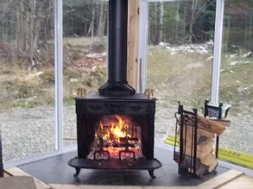

How about a Franklin stove they can be bought cheap and burn with doors open like a fireplace

That what I like about the old franklin stove I have seen them for free a few times around here you can pick them up for less than $200 on a regular basis main cost would be the chimney. I would put one on my patio if it wasn't covered with a deck .

Agreed. Definitely make the stove installation and chimney safe and codeworthy, but I wouldn't worry about efficiency in this case. The Franklin would work. An old Jotul F8 would also do well, so would an old Fisher or clone with double doors.

We really like the idea of an old Franklin (or other older, less expensive stove). It won't get rained on unless there weather is extreme
but I am worried it will rust. I guess rusting isn't a big problem unless it gets one dirty every time they touch the stove.
